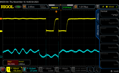

  • We have checked the SDA and SCL signals in scope refer the attached pic.
  • we cannot use HAL_I2C_IsDeviceReady(). because we are using FMPI2C In STM32F410C8U6
    only we can use HAL_FMPI2C_IsDeviceReady().
  • we have connected the 10k to ADD pin so our address becomes the 3ERigolDS10.pngplease refer to waveform only serial clock coming but there is not serial data
  • Is there any chance that IC's I2C peripheral not working???

  • "Is there any chance that IC's I2C peripheral not working???  " : If you comply the absolute maximum ratings given in the Datasheet, it should work.
  • Understood, have you respected the following initialization of the FMPI2C before using HAL_FMPI2C_IsDeviceReady() to check if target device is ready?
    • Enable the FMPI2Cx interface clock
    • FMPI2C pins configuration (Enable the clock for the FMPI2C GPIOs + Configure FMPI2C pins as alternate function open-drain)
    • NVIC configuration if you need to use interrupt process
    • DMA Configuration if you need to use DMA process
    •  Configure the Communication Clock Timing, Own Address1, Master Addressing mode, Dual Addressing mode, Own Address2, Own Address2 Mask, General call and Nostretch mode in the hfmpi2c Init structure.
    • Initialize the FMPI2C registers by calling the HAL_FMPI2C_Init(), configures also the low level Hardware (GPIO, CLOCK, NVIC...etc) by calling the customized HAL_FMPI2C_MspInit(&hfmpi2c) API.
  • "Pease refer to waveform only serial clock coming but there is not serial data" : It seems that's the opposite but I don't understand this behavior. You can find here the errata sheet. Please read the I2C chapter.
