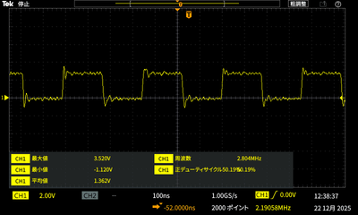

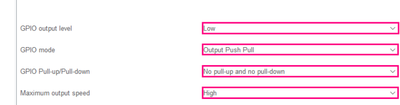

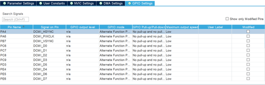

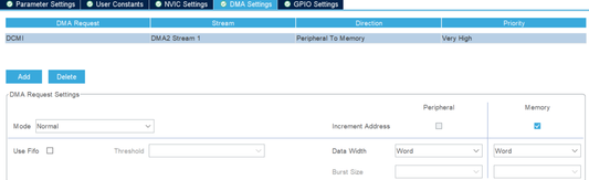

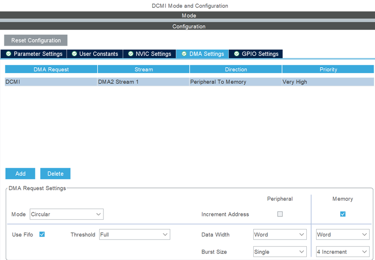

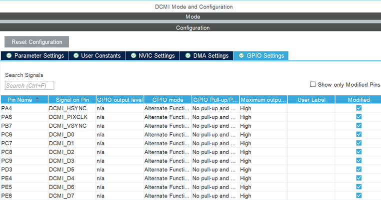

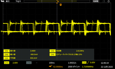

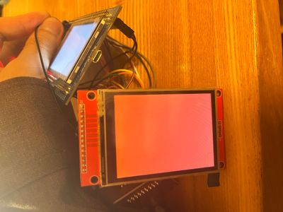

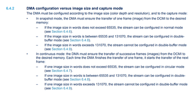

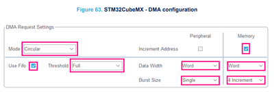

OV7670 + STM32F429 (DCMI + DMA) + ILI9341 SPI — LCD works, no camera image yet
I am currently working on interfacing an OV7670 camera with an STM32F429 using DCMI + DMA, and displaying the captured image on an ILI9341 LCD (SPI interface).
I have successfully confirmed that the LCD itself works correctly (for example, filling the screen with a solid red color).
However, no camera image is displayed, so I suspect there may be an issue with the camera operation or the DCMI configuration.
I am using the following repository as a reference:
https://github.com/PHANzgz/STM32-H7-camera-interface-and-display
Since this project is originally for STM32H7, I have modified the configuration as much as possible to make it suitable for STM32F429.
At this point, I would like to ask whether there are any STM32F4-specific considerations, missing settings, or common pitfalls when using OV7670 with DCMI + DMA.
Any advice or working references for OV7670 + STM32F429 would be greatly appreciated.

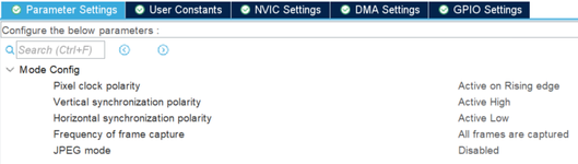

 hdcmi.Instance = DCMI;
 hdcmi.Init.SynchroMode = DCMI_SYNCHRO_HARDWARE;
 hdcmi.Init.PCKPolarity = DCMI_PCKPOLARITY_RISING;
 hdcmi.Init.VSPolarity = DCMI_VSPOLARITY_HIGH;
 hdcmi.Init.HSPolarity = DCMI_HSPOLARITY_LOW;
 hdcmi.Init.CaptureRate = DCMI_CR_ALL_FRAME;
 hdcmi.Init.ExtendedDataMode = DCMI_EXTEND_DATA_8B;
 hdcmi.Init.JPEGMode = DCMI_JPEG_DISABLE;
 if (HAL_DCMI_Init(&hdcmi) != HAL_OK)
 Error_Handler();

 htim3.Instance = TIM3;
 htim3.Init.Prescaler = 0;
 htim3.Init.CounterMode = TIM_COUNTERMODE_UP;
 htim3.Init.Period = 7;
 htim3.Init.ClockDivision = TIM_CLOCKDIVISION_DIV1;
 htim3.Init.AutoReloadPreload = TIM_AUTORELOAD_PRELOAD_DISABLE;
 if (HAL_TIM_Base_Init(&htim3) != HAL_OK)
 Error_Handler();
 sClockSourceConfig.ClockSource = TIM_CLOCKSOURCE_INTERNAL;

 * Enable DMA controller clock
static void MX_DMA_Init(void)
 /* DMA controller clock enable */
 __HAL_RCC_DMA2_CLK_ENABLE();
 /* DMA interrupt init */
 /* DMA2_Stream1_IRQn interrupt configuration */
 HAL_NVIC_SetPriority(DMA2_Stream1_IRQn, 5, 0);
 HAL_NVIC_EnableIRQ(DMA2_Stream1_IRQn);

Fig.1 LCD with red color
Thank you.

My implementation is based on "STM32-H7-camera-interface-and-display".
I tested both single-frame and continuous capture modes.
Single-frame capture works, but continuous capture does not keep running.
I suspect that this approach may have limitations on the STM32F429I-DISCO board.
URL:https://github.com/PHANzgz/STM32-H7-camera-interface-and-display

 GPIO_InitStruct.Pin = CAMERA_PWR_DWN_Pin;
 GPIO_InitStruct.Speed = GPIO_SPEED_FREQ_HIGH;
 HAL_GPIO_Init(CAMERA_PWR_DWN_GPIO_Port, &GPIO_InitStruct);
 /*Configure GPIO pin : CAMERA_RESET_Pin */
 GPIO_InitStruct.Pin = CAMERA_RESET_Pin;
 HAL_GPIO_Init(CAMERA_RESET_GPIO_Port, &GPIO_InitStruct);
 Error_Handler();

Are you using ST board? If yes could you please share the reference?
What are the configured GPIO settings?
Could you please check if the CAPTURE bit in DCMI_Cr register is enabled?
Thank you.
Kaouthar
Thank you for replying.
I'm using STM32 F429I DISCO1.
These are DCMI setting.
➡Yes
KDJEM.1
Hello @chachamaru ;
The DMA must be configured according to the image size (color depth and resolution) and to capture mode.
I recommend you to refer to AN5020 and check the DMA configuration requirements.
May be, you need to change the DMA mode from normal to circular?
Please check the maximum output speed?
Thank you.
Kaouthar
I checked DMA setting on DCMI.
I coudn't change GPIO output level.
KDJEM.1
Hello @chachamaru ;
What is the image size (resolution and color depth)?
Is your issue solved by using DMA circular mode?
->I coudn't change GPIO output level.
I have recommended that you check the “maximum output speed.”
The shared image corresponded to GPIO_output pin configuration for a camera power pin.
I advise to look at AN5020 section 8.3 DCMI examples based on STM32CubeMX may help you.
Thank you.
Kaouthar
The image size is QVGA (320 × 240)
and the color depth is RGB565 (16 bits per pixel).
No. I tried DMA circular mode, but the issue remains unchanged.

KDJEM.1
Hello @chachamaru ;
Could you check the waveforms of the DCMI signals using an oscilloscope?
Thank you.
Kaouthar
I chacked the waveforms of DCMI signals.
Fig.1 DCMI_D7 signal
Fig.2 DCMI_D7 Single waveform signal
I was finally able to display the camera image on the LCD, although it is not completely perfect yet.
Thank you very much for your help and support throughout this discussion.
