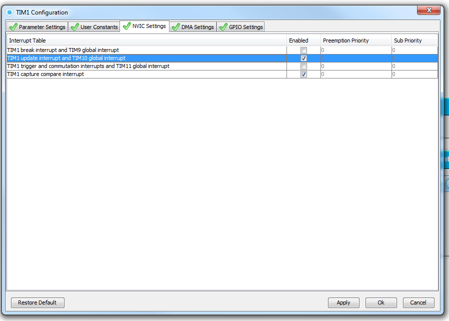

I'm working on STM32F215 and I generate a PWM output on TIM1. This signal is going to an other device.
For synchronization purposes on this signal, I would like to get the rising and falling edge of it.
My first thought is to link the PWM ouptut directly to a EXTI pin in order to get my edges interrupt.
I just begin working withTimerbut I'm just there is a simple way to get those PWM informations.
Could you please help me with a code example/interrupt configuration ?

John Craven
Senior
Posted on February 01, 2018 at 15:28
Drill into the HAL_TIM_PWM_Start_IT method.
You'll see it sets the Compare event interrupt with;
      __HAL_TIM_ENABLE_IT(htim, TIM_IT_CCx);
Directly after your Start IT call, add the following to also enable the Update event;
      __HAL_TIM_ENABLE_IT(htim, TIM_IT_UPDATE);
in your case, based on your code sample, it would look like;
      HAL_TIM_PWM_Start_IT(&_t_HTIM1, TIM_CHANNEL_3)
      __HAL_TIM_ENABLE_IT(&_t_HTIM1, TIM_IT_UPDATE);
If you are using a CubeMX generated project,
you have to check both interrupts
the interrupts can be handled in
TIM1_UP_TIM10_IRQHandler(void) for the update event
TIM1_CC_IRQHandler(void) for the compare event
or you can provide your own own handlers for the weak methods;
void HAL_TIM_PWM_PulseFinishedCallback(TIM_HandleTypeDef *htim) for the compare event
void HAL_TIM_PeriodElapsedCallback(TIM_HandleTypeDef *htim) for the update event
If you are using count UP, active HIGH polarity;
Update event is rising edge, state is HIGH in handler
Compare event is falling edge, state is LOW in handler

Posted on February 01, 2018 at 14:50
Thank you for your answer!
My code is based on the STM Cube generated code.
Ok, so I enabled TIM1_UP_TIM10_IRQn and TIM1_CC_IRQn in the dedicated MSP function.
This is my OC configuration :
__t_ConfigOC.OCMode = TIM_OCMODE_PWM1;
__t_ConfigOC.Pulse = 63; // default 6.3ms
__t_ConfigOC.OCPolarity = TIM_OCPOLARITY_HIGH;
__t_ConfigOC.OCNPolarity = TIM_OCNPOLARITY_HIGH;
__t_ConfigOC.OCFastMode = TIM_OCFAST_DISABLE;
__t_ConfigOC.OCIdleState = TIM_OCIDLESTATE_RESET;
__t_ConfigOC.OCNIdleState = TIM_OCNIDLESTATE_RESET;
I start the PWM using HAL_TIM_PWM_Start_IT(&_t_HTIM1, TIM_CHANNEL_3) function.
I go to the CC Handler but not into the Update Handler. Do I miss something?
Thank you,
Marc

Posted on February 01, 2018 at 16:16
Both interrupts can be handled with the global
TIM1_IRQHandler
AFAIK there's no such.
(for TIM1 particularly, there are separate interrupt vectors for update and for the captures, so you don't need to distinguish them in the ISR)
Posted on February 01, 2018 at 16:20
Hi John!
Thank you very much.
I see now in the 'HAL_TIM_PWM_Start_IT' function, it enables only CCx.
The 'HAL_TIM_Base_Start_IT' function performes the __HAL_TIM_ENABLE_IT(htim, TIM_IT_UPDATE);
I get into both interrupts now.
Thank you guys,
Marc
Posted on February 01, 2018 at 16:38
If he generated the project with CubeMX, and enabled the TIM1 global interrupt there is!
he would have a handler like this;
void TIM1_IRQHandler(void)
  /* USER CODE BEGIN TIM2_IRQn 0 */
  /* USER CODE END TIM2_IRQn 0 */
  HAL_TIM_IRQHandler(&htim1);
  /* USER CODE BEGIN TIM2_IRQn 1 */
  /* USER CODE END TIM2_IRQn 1 */
It calls HAL_TIM_IRQHandler(&htim1);
which then calls the event specific handlers;
