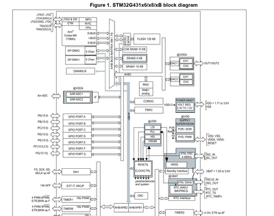

i have two questions here:
A: That line should not be there, so the bar downwards would be the AHB2?
B: This is APB1?

you talking about ...?
this: ?
Yes, i forgit to include it. I just added it.

Hi @Tobe ,
Thank you for bringing this issue to our attention.
I will check internally  and I will get back to you with more details as soon as possible.
Thank you.

Take this with you: (it should be right i think)
KDJEM.1
Hi @Tobe ,
I confirm the issue and I reported internally.
Internal ticket number: 167372 (This is an internal tracking number and is not accessible or usable by customers).
Thank you for your contribution in STCommunity :).
