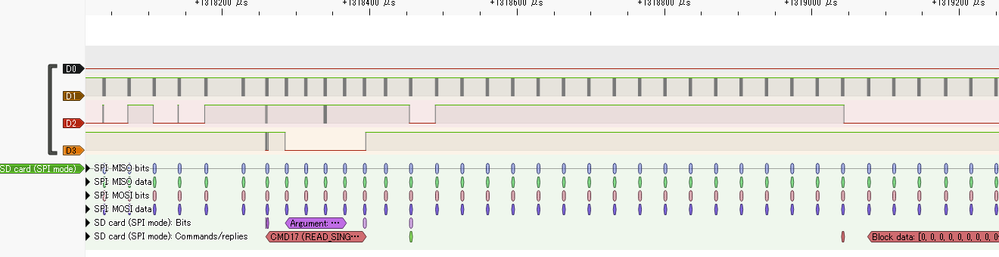

The analysis results from the logic analyzer are shown in the following image, and a response to CMD17 has been received.

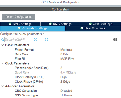

The strange thing is the SPI settings. The SD card specifications state that the SPI mode should be Mode 0, but in reality, communication fails on the first CMD0 if it's not Mode 3. Also, communication is not possible unless the SPI clock is set to 1MHz or higher (in this case, 32MHz (MCU) / 8 = 4MHz (SPI)).
The pin assignments and SPI settings are as shown in the diagram.

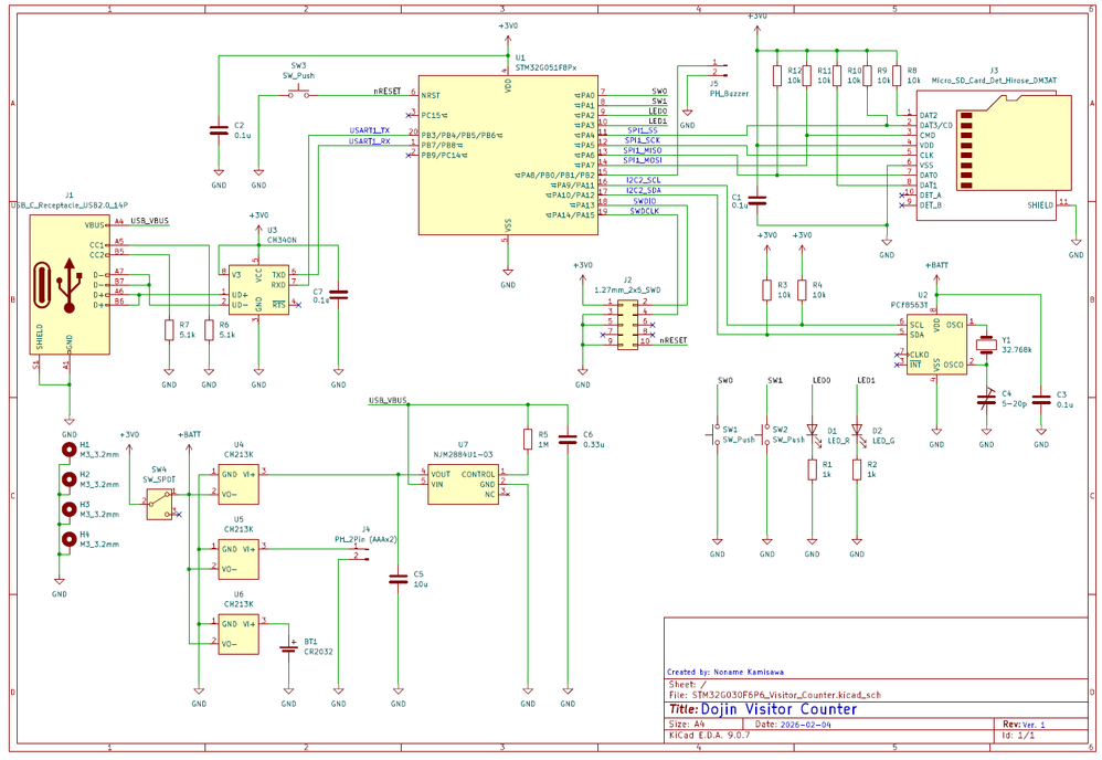

The circuit being debugged is as shown in the diagram, and all signal lines on the MicroSD card except SCK (including DAT2 and DAT3, which are not used in SPI mode) are pulled up with 10kΩ resistors.

You should use the SPI mode 0 as stated in SD card specification.
Saket_Om
@Saket_Om -san,
Hmm, I did try setting the SPI mode to Mode 0 as per the SD card specifications, but the communication failed at the initial CMD0 transmission stage.

The schematics look reasonable, and 4MHz SPI clock should not be a problem, assuming the PCB traces are not too long. And since the SPI signals are associated, the PCB traces should have about the same length and characteristic impedance. At 4MHz, series resistors are probably not necessary - although I'm no hardware guy.
And because if somewhat mixed experiences with MCU SD card interfaces in the past, have you tried different SD cards, of different (storage) size ?
