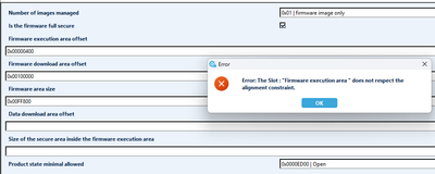

I've tried some stuff in Project Manager -> Boot path -> Edit config files
If I put the following information in I get an error
If I use offset zero and size 0x100000 it does work.
Can I assume that STM32CubeMX handles the rest (0x400 offset and appended signature on the end of the firmware)? It somewhat confusing.
