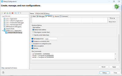

STM32H750B-DK TouchGFX Project: "Cannot access memory at address 0x90000000" During Debug
Board: STM32H750B-DK (DK32H750B$AT1)
IDE: STM32CubeIDE 1.14.1
CubeMX: 6.11.1
TouchGFX: 4.23.1
Firmware: STM32Cube FW_H7 V1.12.1
Problem Description:
I created a new TouchGFX project for the STM32H750B-DK board. The project builds successfully (0 errors, 1 warning), but I cannot debug it. When starting a debug session, I get the error: "Cannot access memory at address 0x90000000".
The project is configured to use external QSPI flash (0x90000000) for code execution (XIP) since the code size (424KB) exceeds the H750's internal flash (128KB).
What Works:
  • Project builds successfully
  • Simple non-TouchGFX blinky projects debug successfully

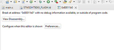

What Fails:
  • Debug session fails with memory access errors at 0x90000000
  • Attempts to set SP/PC from external flash vector table fail
As found
STMicroelectronics ST-LINK GDB server. Version 7.12.0

Any guidance on proper debug configuration for external flash execution would be greatly appreciated!
NOTE: Shouldn'e external loader be found, where?

ksale.1
ksale.1Author
Senior II
February 6, 2026
attachment 2: linker script

  • Default debug launch always halted at 0x80011b0 (internal flash), ignoring external flash.
  • Attempt 1 (VTOR): Added SCB->VTOR = 0x90000000; early in main() and also tried setting it via GDB Run Commands (set *((unsigned int *)0xE000ED08) = 0x90000000).
  • Result: The debugger seemed to jump but immediately hit a HardFault or Lockup state. The processor appears to crash as soon as it tries to fetch instructions from external flash.
  • Attempt 2 (Run from CubeProgrammer): Used CubeProgrammer's "Run after programming" feature. The board enters a locked state (no functional code execution, debugger reports "ARM M in lockup state").
3. Current Status & Questions
