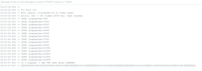

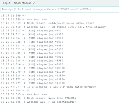

Clock Configuration
  • No external crystal or clock source is used.
  • The project relies only on the internal clock (HSI).
  • Clock information (SystemCoreClock, RCC registers) is printed after reset.
  • From the serial output:
    • Clocks appear correct after a power-cycle reset
    • Clocks appear to be incorrect or degraded after waking from Standby on the problematic PCB

Test Results
  • Case 1 – Problematic PCB
    • Serial output contains garbage after Standby wake-up
    • All timing functions run slower than expected
  • Case 2 – Proper PCB
    • Serial output and timing behave correctly

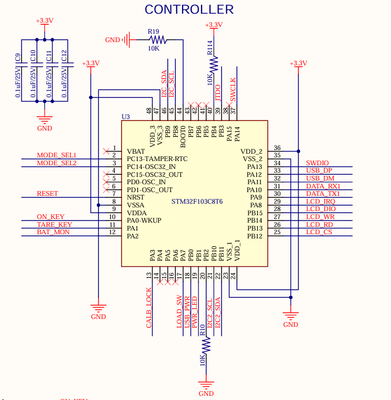

I have also included schematic diagrams for the power and controller circuits
Shanmugapriya_2-1770483300040.png    Shanmugapriya_3-1770483305630.pngShanmugapriya_4-1770483317801.png
Why would two PCBs with the same schematic and firmware exhibit different clock behavior after exiting Standby mode, leading to timing issues on one board?
What could cause the system clock to collapse or run slower after Standby on only one PCB, and how can this be fixed?
