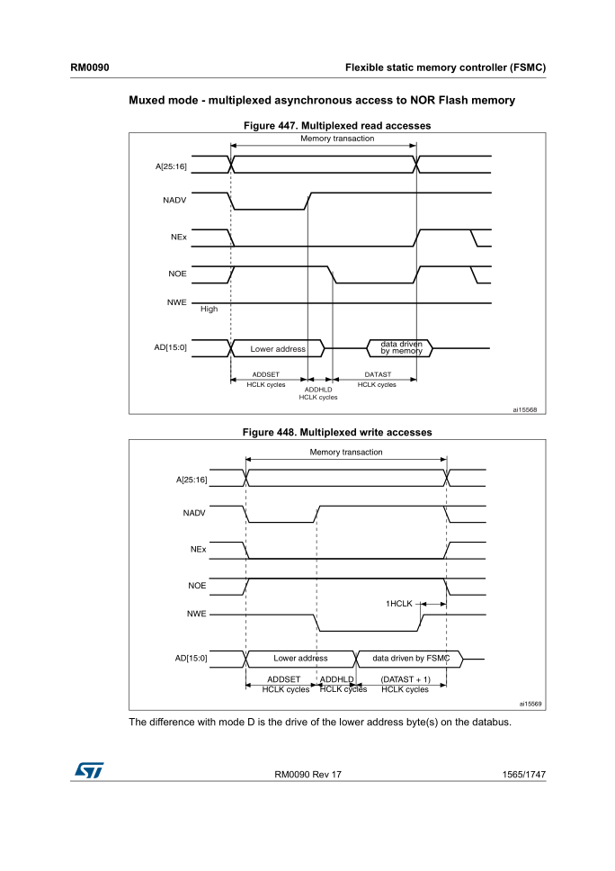

The high portion of address is output onto A16-A23 during the whole read/write cycle.
The low portion of address i.e. A0-A15 is output to DA0-DA15 the first half of the read/write cycle, and you have to latch it using the NADV=NL signal. Then, in the second half of read/write cycle, data are read/written on DA0-DA15.

Thank you for the explanation. So, the higher portion of the address is always output on A[16.23]. OK, given that the ASIC I'm interfacing has only 4-bits of addressing and allows for multiplexed bus transactions, in this case I suppose the address data will be latched on the first 4 DA bits (upon activating Address-Valid signal) and nothing will be output on the A[16.23] lines, right?

Do you need the external memory area as viewed from the processor to be continguous?
If not, i.e. if you are going to access it as 16 separate "registers", you may as well avoid using the multiplexed mode entirely. You would then simply use the simplest straightforward "SRAM" mode, use e.g. A16..A19, and access the "registers" at addresses 64kB apart, e.g. first "register" at 0x6000'0000, second at 0x6001'0000, etc.
Whether this is viable, of course depends on your particular application.
