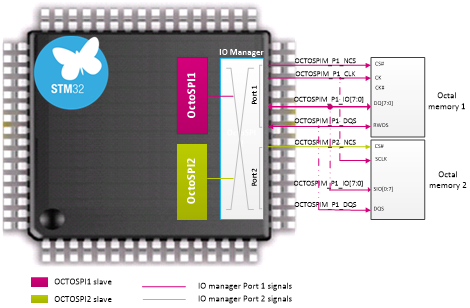

The new STM32L4+ brings several new innovative features. It comes with newer OctoSPI interface enabling to connect Octal flash and PSRAM memories and HyperBusTM memories as well.
OctoSPI: Connecting 2 Octal SPI memories using only one physical interface
Thanks to its new multiplexed mode, it enables connecting 2 Octal memories using only one physical interface.

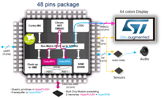

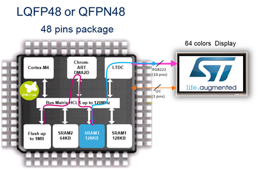

Basic HMI on Small 48-pins packages (Optimized BOM)
β€’      Only MCU + Display: Ideal MCU for Basic HMI applications with a small low cost packages
β€’      ALL inside a small device : CPU, Display driver, 2D Accelerator, GFX RAM, Flash, and others….
β€’      LTDC RGB222 configuration available on ALL packages
β€’      CLUT L8 color format
β€’      Single or double buffer ( 240x240 8-bpp)
=> No need for External memories
=> No need for external Display controller
More advanced HMI + Audio + UART+ Others
β€’HMI (LTDC+OctoSPI) + Audio + Sensors + UART + 10_spare_pins
β€’When internal RAM/Flash is not enough
β€’LTDC RGB222 configuration available on ALL packages
β€’2 External Octal SPI memories thanks to the multiplexed mode
β€’HyperFLASH
β€’HyperRAM
β€’Audio Codec over SAI
β€’I2C for Display, sensors and Audio Codec
β€’UART
β€’10 spare pins

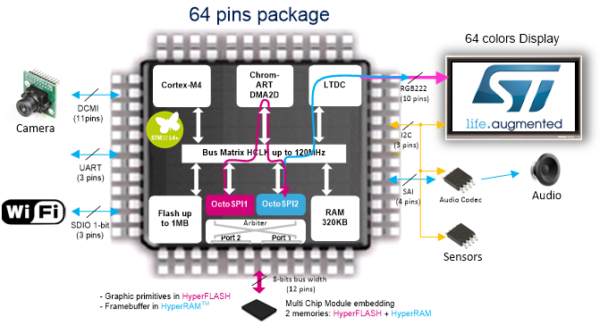

HMI + Audio + Camera + Connectivity + Others
β€’HMI (LTDC+OctoSPI) + Audio + Camera + Wi-Fi + Sensors + LPUART + 2x SPI + 10_spare_pins
β€’Thanks to following features availability on LQFP64 package
  1. LTDC RGB222 configuration available on ALL packages
  2. 2 External Octal SPI memories thanks to the multiplexed mode
  3. Audio Codec over SAI
  4. Camera over DCMI 8-bits
  5. Wi-Fi module through SDIO 1-bit
  6. I2C for Display, sensors and Audio Codec
  7. LPUART
  8. 2xSPI or USB_OTG_FS …
  9. 10 spare pins

With a low cost package (LQFP48 or QFN48) you can build your Graphic application, thanks to the GFX peripherals availability on such small package and also thanks to the new innovative Octal SPI feature named multiplexed mode. On that small package you don't need an external TFT driver thanks to the LTDC, and you don't need to add an external RAM for GFX framebuffer and ext flash for bitmaps thanks to the internal 1MByte of flash and internal 320Kbyte of RAM. But if your application requires more RAM and more flash, no matter thanks to the 2x Octal SPI interfaces, you can connect 2 different octal memories through the same data lines thanks to the multiplexed mode. One memory can be a flash (or HyperFlash) for bitmaps and the other can be an HyperRAM (or SRAM or PSRAM) for Graphic framebuffer.
The RGB222 is a reduced bus for the LTDC interface used to transfer pixels to the display. (2 lines for Red, 2 for Green and 2 for Blue) instead of using the full RGB888. For this mode of 6bits-per-pixel you get 64 colors in display which is quite enough for most HMI appliances. This configuration reduces considerabely the PCB design complexity, the cost and the used GPIOs especially for reduced pin packages.
