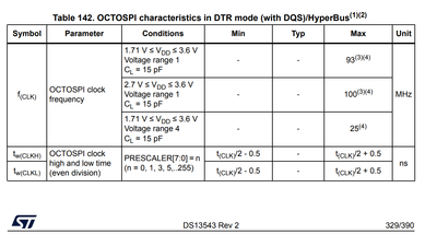

Could you please refer to STM32U5 data sheet and check the maximum OCTOSPI clock frequency in table OCTOSPI characteristics in DTR mode (with DQS)/HyperBus(1)(2)
The below table is OCTOSPI characteristics in DTR mode (with DQS)/HyperBus for STM32U5A.
Thank you.
Kaouthar

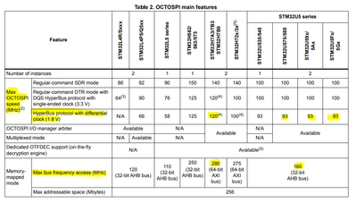

However I am a bit confused, I am using the Hyperbus OCTOSPI in memory mapped mode and in AN5050 I just found this table saying the U5-series should support 160 MHz.
Please help me clarify,
many thanks in advance

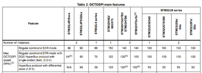

The max AHB bus frequency access indicated in An5050 table 2 is the maximum bus frequency used for the data register.
You can show the max OCTOSPI communication frequency in "Max OCTOSPI speed (MHz) line" in AN5050 table 2.
Note that this max frequency depends on voltage scaling as mentioned in the datasheet.
I hope this answer your request.
Thank you.
Kaouthar
2024-06-27 6:10 AM
Thanks,
I am using 3.3V + single clock + memory mapped mode.
I seems 160 MHz should be supported, but I am still confused since you yellow marked double rows in the tablle.
Could you please explicity confirm?

Hi @Southbranch ,
The maximum OCTOSPI frequency for STM32U5 is 100 MHz not 160 MHz. The 160 MHz is the max AHB bus frequency.
Thank you.
Kaouthar
