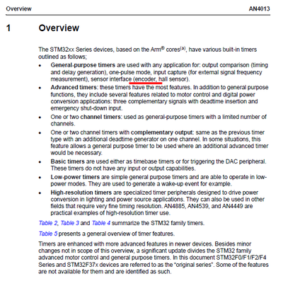

AN4013 seems to suggest that any 'General-Purpose' or 'Advanced' Timer can do it:
