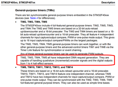

@Vidicon wrote:Mostly yes,

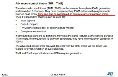

but it does not mention encoder mode for the Advanced-control timers TIM1, TIM8.
AN4013 suggests that 'Advanced' Timers can do everything that 'General-Purpose' Timers can do, and it says that includes the Encoder mode.
But, indeed, the Datasheet says that only some 'General-Purpose' Timers (TIM2-5) have the Encoder mode:
and the description of 'Advanced' timers is unhelpful:
Another 'Documentation Clarification' request for @STOne-32 and @Imen.D
‎2024-02-19 4:26 AM - edited ‎2024-02-19 4:27 AM
I don't know where cube gets this information from,
In the timer xmls in IP subdirectory you'll find something like:
<Mode Name="Encoder_Interface" UserName="Encoder Mode" RemoveCondition="($IpNumber=6)|($IpNumber=7)|($IpNumber=18)|($IpNumber=9)|($IpNumber=10)|($IpNumber=11)|($IpNumber=12)|($IpNumber=13)|($IpNumber=14)|($IpNumber=15)|($IpNumber=16)|($IpNumber=17)">
note the RemoveCondition tag, i.e. this is list of timers (timers' numbers) which don't have encoder mode. Others do.
otherwise I could write a script to list all devices with 5 or more timers with the encoder mode.
If you do, please publish.
‎2024-02-19 4:29 AM
RM0090 17.2 TIM1 and TIM8 main feature:
• Supports incremental (quadrature) encoder and hall-sensor circuitry for positioning
purposes
You should also have a look at AN4013
‎2024-02-19 4:53 AM
@Uwe Bonnes wrote:You should also have a look at AN4013
That's the one I've been citing - it seems not entirely helpful:
