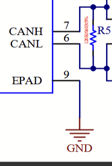

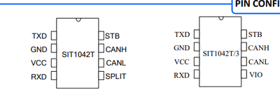

Another question,
In the datasheet the transceiver is an 8 pin package:
 while in the schematics the transceiver has the pin 9 called "EPAD":
.. not sure if this the same transceiver part number..
This is usually a metallic & conductive connection to die bulk, often cooling fins. Sometimes simply the exposed die itself.
However, the standard version of this transceiver is 5V logic, as I understood it.
Only the xxx/3 version is 3.3V logic. I would at least check.
