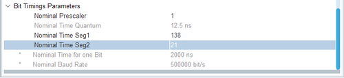

Basically I am unsure what is missing in my board's configuration or code. I have followed many guides to configure the .ioc, I even found some code by the manufacturer (not the settings I would like to use though, it is for FDCAN 1 250 000, which I am unsure what to think of by the way as, at least for python-can, 1 250 000 seem to be not a supported rate, thus I could not test with it much). For the timing configuration, I have used Kwaser's calculator for FDCAN, I found this configuration (from my understanding, the Data should not matter much with classical CAN) :

Your IOC file shows the FDCAN clock is 80MHz
Based off that, your settings should be as following to get 500000 bit/s
https://kvaser.com/support/calculators/can-fd-bit-timing-calculator/?v=0.12&nbr=500000&dbr=1000000&nsjw=21&dtps1=40&dtps2=39&f=80000&t=5000&d=200&np=1&dp=1
