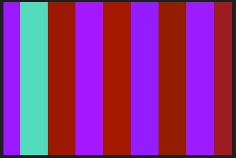

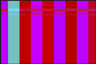

  1. The ideal timing requirements are met only if D-CACHE is enabled. In this case everything executed properly the data acquisition runs smoothly without issue. However, the image data contains artifacts. And it is because the DMA2 copies the internal SDRAM content to GPIOB while the CPU still has data in D-CACHE and it did not store the data to internal SRAM, in fact it took approx.  60ms to update all the frame in sram. Here is an example image, with a dummy signal where the color bars changing colors at each vsync event. E.g. the red bar becomes pink and pink bar becomes red. It can be seen some pixel data remains at previous color but most of them are updated and was read out successfully with the parallel bus.
  2. If I disable the D-CACHE, the performance drops too much, and the timing requirements of the ideal operation is not met. E.g. the calculation time of the ycrycbToRGB16() function increases from ~7ms to 20ms which is not acceptable. With D-Cache the algo finished sooner, but the data was not there in the internal sram. So either solution is not ok.
    Here is another test frame:
    The image does not contain any artifact, but the capture rate dropped to 15FPS instead of 30FPS because of the slowing down to access to SDRAM.

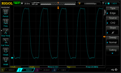

  3. If I increase the clock rate of the parallel bus, from 10MHz to 20MHz the timings are “crashed”. It seems stm32 is missing clocks from the external controller and therefore the data transmission breaks. The clock signal looks like this on the proto (with 20MHz clock):
All the parallel bus lines has a 120ohm series resistor now.

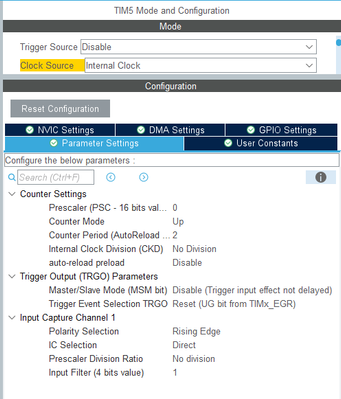

  • The TIM5 configured with no preclear and autoload of 2

Hardware / 20 MHz:
- the 120 Ohms seem a little high, maybe the flanks are not steep enough for some IO
- have you set all GPIOs to highest speed possible?

Seems like the issue is not related to the series resistor, but I replaced it to 10R. So here is the thing, I could manage to increase the parallel bus speed to 25MHz from 10Mhz, but it works only, if the audio capture is disabled. Without audio capture, the video stream runs smoothly. When I enable the audio capture, the DMA stream for parallel out is corrupted somehow... Both peripheral uses the DMA2 (Stream0 and Stream1). The DMA streams are configured as:

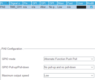

For all GPIOB the output speed is very high as they are configured as digital output. For clock input, I am not sure if I can set high speed for timer input. In GPIO config of cubeide I see this:
I do not know if it make sense to change the "Maximum output speed". The signal is input. Will check this.
And I have this timer config:

The speed register settings only apply to outputs. But mind that the data lines to a memory are usually bi-directional.
