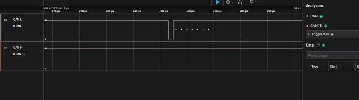

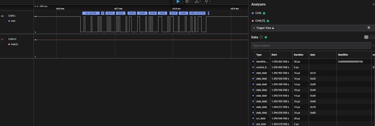

Hi all,
For several days I have been trying to send and receive something via CAN, but I am unable to do so on the Riverdi LCD board. I read two posts here with similar problems and instructions and videos from ST, but it did not solve my problem. CAN still does not work in normal mode. I tried too on loopback mode
STM board: >>  Riverdi board
 On the second board with nucleo 64, I made a simple program that sends 8 bytes and works correctly.
But riverdi board send like this
Now FDCAN set is to 40Mhz and this is code fdcan.c:

I cant send or recived data. When canfilterconfig.FilterID1 = 0x100; and i send data from secound board riverdi lcd frozen and i can only reset board. But when i change to other ID like 0x101 no frozen.  Callback Can is never performed
