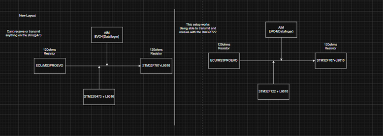

Hey I am having trouble tryng to connect my stm32g473 to a canbus. I am using a l9616 as a transceiver and the bus is functions as I have connected to it with an stm32f722re with the same l9616.
The clock is 64Mhz,Ive used the canbit time calculation website to define the values of nominal time 1 and 2 to achive 500kbs.
Also using NVIC and it seems to be configured fine. When tested in loopback the interrupt is called and the messages are received.
This is the init with the filter config,as I ve understand I am not filtering anything and any of the messages on the bus should get to my uC.
When running the state of hfdcan1 is Busy and also no error code show up.

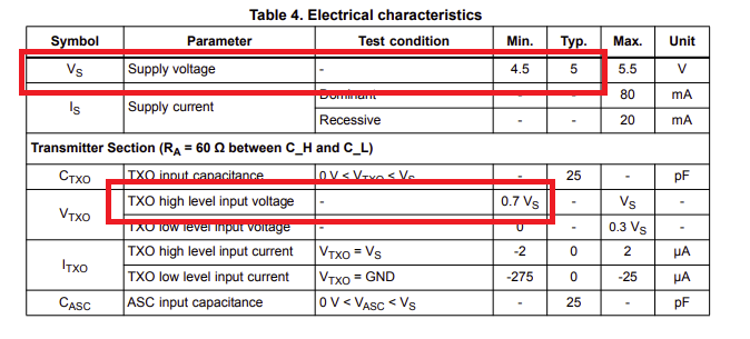

Looking at the transceiver datasheet:
VTXO min = 0.7Vs = 0.7x5 = 3.5V > MCU VDD.
That tranceiver is an automotive grade ans it's not compatible with STM32.
Use a 3.3V transceiver like SN65HVD230 .

About the transceiver,I ve used with many stm32f7 and it worked fine. I will try to search for a substitute but i dont think thats the issue.

Sure,but wouldnt that be an issue just to send messages? Cause I cant receive any message from the bus,I measured the tx pin with an oscilloscope and it reads a digital signal.
I tested another board that I have with an f722re that doesnt support the fdcan paired with the l9616 and it did connect and could receive and transmit messages to the bus,which to me looked like the issue with the stm32g473 was related with the code or maybe something inside the microcontroller related to the fdcan hardware.

I already ordered a 3.3v compatible transceiver and should get to me in around 2 weeks. I will come back to comment if that was the solution.
Indeed you need definitely to replace l9616 transceiver.
Okay,just resoldered a new microcontroller and then the canBus started working,maybe I damaged these pins when testing or smth.Anyways now everything works receiveing and transmiting with the l9616.
Still probably gonna change the transceiver to have better relliability.
 My layout is down here just to clarify what was happening.
Appreciate for the help.
