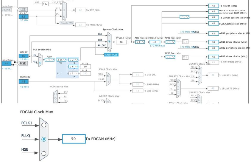

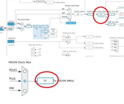

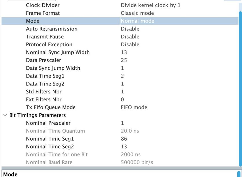

We’re currently developing an OBD reader using an STM32G473, which includes three FDCAN controllers. Each FDCAN interface is connected to a TCAN3413 transceiver.
As part of our testing setup, we built an ECU simulator using an Arduino with an MCP2515 controller and a TJA1050 transceiver, and this simulator works perfectly.
However, we’re facing a major issue when trying to send CAN requests from our STM32-based board to this ECU simulator. We’re not able to make the FDCAN controller operate in Classical CAN 2.0 mode and send messages correctly.
We verified this by checking both the RX and CAN lines of the transceiver with an oscilloscope. The TX signal from the STM32 does not show the expected data pattern.
That said, the transceiver itself is working correctly, when we send data from the Arduino node, the RX pin on the transceiver shows a clean, valid CAN signal. The issue seems to be that the STM32’s FDCAN controller doesn’t properly interpret or transmit standard CAN 2.0 frames, and as a result, we can’t see any valid messages on the microcontroller side.
To make it easier to understand our setup, we’re attaching several images:
  • Our clock configuration from STM32CubeMX
  • The main.c source file
  • The FDCAN1 peripheral configuration we’re currently using
We’d really appreciate any help or insight from the community on how to correctly configure the FDCAN peripheral on the STM32G473 to work in standard CAN 2.0 mode, compatible with MCP2515-based nodes.
Thanks in advance for any advice or configuration examples you can share!

  hfdcan1.Instance = FDCAN1;
  hfdcan1.Init.ClockDivider = FDCAN_CLOCK_DIV1;
  hfdcan1.Init.FrameFormat = FDCAN_FRAME_CLASSIC;
  hfdcan1.Init.Mode = FDCAN_MODE_NORMAL;
  hfdcan1.Init.AutoRetransmission = DISABLE;
  hfdcan1.Init.TransmitPause = DISABLE;
  hfdcan1.Init.ProtocolException = DISABLE;
  hfdcan1.Init.NominalPrescaler = 1;
  hfdcan1.Init.NominalSyncJumpWidth = 13;
  hfdcan1.Init.NominalTimeSeg1 = 86;
  hfdcan1.Init.NominalTimeSeg2 = 13;
  hfdcan1.Init.DataPrescaler = 25;
  hfdcan1.Init.DataSyncJumpWidth = 1;
  hfdcan1.Init.DataTimeSeg1 = 2;
  hfdcan1.Init.DataTimeSeg2 = 1;
  hfdcan1.Init.StdFiltersNbr = 1;
  hfdcan1.Init.ExtFiltersNbr = 0;
  hfdcan1.Init.TxFifoQueueMode = FDCAN_TX_FIFO_OPERATION;
  if (HAL_FDCAN_Init(&hfdcan1) != HAL_OK)
    Error_Handler();

mƎALLEm
Hello @Onlywavesmdp and welcome to the ST community
1- Please attach your ioc file
2- You need also to share the schematics
3- Did you try the External Loopback mode?
Question: why FDCAN clock > System clock frequency?
Increase the system clock. Let's say the max frequency at 170MHz using the PLL and keep the FDCAN clock set at 50MHz.
Hi @mƎALLEm , here I’m attaching the .ioc file.

As for the FDCAN clock frequency in relation to the system clock frequency, that was just part of our testing. We tried multiple frequency values, some lower than the system clock. For example, we tested the FDCAN clock at 8 MHz while the system clock was at 48 MHz, but the system still didn’t work.
Thanks a lot for your quick reply and for taking the time to help!

3- Please change the system clock to be clocked from the PLL as the following:
So the system clock frequency is at 150MHz.

Hi @mƎALLEm , i also configured the system clock as you suggested earlier, using the external 48 MHz HSE crystal and the FDCAN clock remains at 50 MHz.
Here you didn't mention what System clock you set.. 150MHz?

Your bit timing doesn't look correct. Typically SJW should be 1 but you have 13. Not sure how that is possible as CubeMX doesn't have the option to change the SJW.
Try these values with FDCAN clock at 50MHz
NSJW and DSJW are configurable in CubeMx
Discussion continuation here regarding this point.
