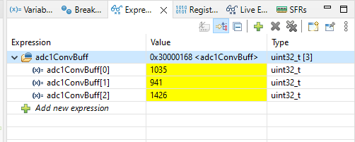

2023-06-09 5:09 AM - edited 2023-11-20 3:47 AM
Hello @JShah.7 (Community Member)
Here attached a STM32CubeIDE project with Trust zone enabled using ADC1 in following context.
The project was designed for B-U585I-IOT02A board, but it should works on your device.
Secure context:
The ADC1 use GPDMA1 CH10 to convert Internal channel VBAT, TEMP_SENSOR and VREF (see watch expression capture below).
PH7 use a Led light on/off to show ADC+GPDMA activity.
adc1ConvBuff[0] = ADC_CHANNEL_VBAT DIV4 ~1034lsb with ADC1 in 12b resolution.
adc1ConvBuff[1] = ADC_CHANNEL_TEMPSENSOR ~941lsb
adc1ConvBuff[2] = ADC_CHANNEL_VREFINT ~1427lsb
Then the secure code start the non-secure code below

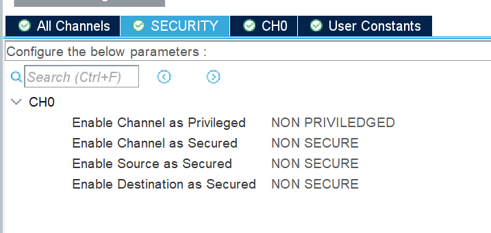

I follow below configuration steps to run ADC in non secure zone.
1)Take above code as reference.
2)Configure ADC1 in non secure.
3)Configure GPDMA for non secure (Security tab->attached pic).
4)only one time get GPDMA interrupt after that not getting.
Please guide me for same or please provide example code for ADC_GPDMA in non secure.

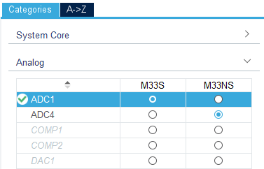

2023-06-12 12:41 AM - edited 2023-11-20 3:47 AM
Hello JShah.7 (Community Member)
Change the Runtime context of your ADC1 in the STM32CubeMX configuration from M33S to M33NS.
Then apply same ADC1 and GPDMA1 Parameters setting than my .ioc example, except for GPDMA1 Security, you need to configure a new Channel in Non Secure/Non Priviledged.
Then configure NVIC _NS to generate new GPDMA channel and ADC1 global interrupt.
Check also Security GTZC_S and GTZC_NS, ADC1 should be configured in Non secure mode.
Regards,
romain,
2023-06-12 2:08 AM
2023-06-12 7:56 AM - edited 2023-11-20 3:48 AM
Here attached my previous project with ADC1 in non secure context (NS) and in 12bit resolution.
I also added ADC1 channel computation en mV for VREFINT, VBAT and Degree Celsius for TempSensor.
I do not implemented ADC4, it's up to you for its implementation where you want.
As explained before, I just changed ADC1 secure context as following.
- Regenerated the projet
- Move ADC1 user code and callback from \secure\main.c to \Nonsecure\main.c
Good luck.
Romain,
