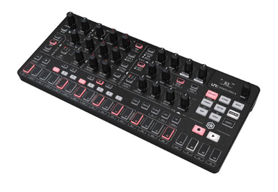

ok, funny...
but wtf you build analog synth ? just for fun ? (hobby, this i could understand :) )
can have analog synth for 500$...
https://www.thomann.de/de/ik_multimedia_uno_synth_pro_x.htm
how many hours you need, to build something like this ? 500 ?
i made my first (and only) digital sampling synth 35 y ago, but Yamaha and Korg been faster... no surprise, they have not only one guy building this.
so tell me, why and for what use ?
