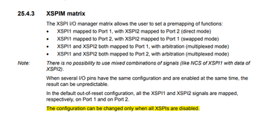

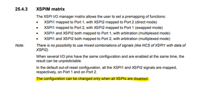

Hello @YoungKwan
According to the reference manual the two XSPI interfaces should be disabled before configuring IO manager.

Hello @YoungKwan
As mentioned in the reference manual the configuration can be changed only when XSPIs are disabled.
Saket_Om
