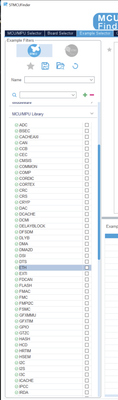

in the MCU selector app, in the Example selector, there is a long list of examples, all using acronyms (see screenshot below). Some are obvious like "ETH" but most are not.
Some questions:
1) Where can I find a table/list that explains what each of the acronyms mean?
2) Where can I find the actual code for each?
3) which one is USB bootloader and SDMMC bootloader?
4) which one is USB mass storage device?
Thank you :)

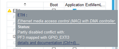

1- In the reference manual of the product:
Example:
Or move the cursor on it:
2- In the Driver folder.
3- There is no bootloader code generated by CubeMx. It's under the user responsibility.
4- No mass storage code generated by CubeMx at this level. You need to configure the interface in Host/Device etc .. And add the USB library (for example to add x-cube-usb-pd) in middleware section.

‎2024-12-25 12:10 AM - edited ‎2024-12-25 12:11 AM
There is no table list of acronyms in the reference manual. The acronyms are part of each chapter title as I mentioned above.
I don't know for MCU finder, but the screendshot I've taken is from CubeMX.

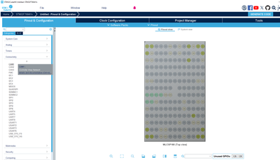

‎2024-12-25 11:58 PM
This is a screenshot from a created project for STM32F769:
Passing through the mouse cursor on CAN1, shows a popup describing the peripheral.
Try to click on the pinout view background and move back the mouse on the peripheral link.
I think MCU Finder does not support that feature. The screenshot you shared in your first comment corresponds to the examples available not to the peripheral configuration.
‎2024-12-28 1:13 AM
Thank you @mÆŽALLEm
yes, as you say, the screenshot I shared in my first comment corresponds to the examples available not to the peripheral configuration. That is what I am looking for: an explanation of each of the examples acronyms, not the peripherals. And without spending ages opening various micros manuals and search for the acronym.
Surely there must be a way to quickly know what each of those examples acronyms stand for?
How can I do that?
