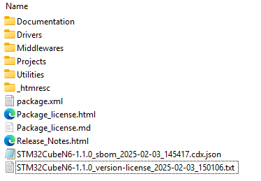

I downloaded the STM32CubeN6 for my STM32N6570-DK, version 1.1.0. from https://www.st.com/en/embedded-software/stm32cuben6.html.
I noticed that there is a newer version 1.1.1 available, but that is a patch, not a package. I haven't found an explanation how that patch should be applied.
Asking that because automatically generated template code with 1.1.0. won't run successfully. DK crashes when calling
HAL_ICACHE_ConfigAssociativityMode()
Any advice to share is appreciated.
Cheers, heke

Pavel A.
While waiting for authoritative reply:
Unpack the patch zip file to a temporary directory. The zip should contain the same structure as the firmware 1.1.0.
Then just copy the whole content onto the firmware 1.1.0 directory; let it overwrite existing files.
(keep backup of the 1.1.0 dir to be safe)
To check - open the firmware manager of the Cube, it should detect the patch. (the version is actually in the file package.xml)
Done.

Copied the patch, file by file to the existing 1.1.0 structure. CubeIDE did not like it.
Anyway, as the patch seems to be adding only one GPIO pin definition, it is easier just the edit the .c file. It is kind of interesting that although the actual diff is only one line in a .c file, the patch size is 45.8MB!
