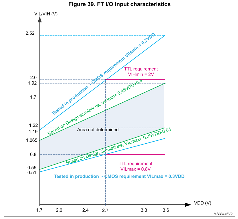

We want to realise a cheap measurement of a external voltage over a voltage divider with a STM32F765ZI processor. We calculate VIL with the formula "0,35*VDD-0,04" which is guaranteed by design. On base of this calulated VIL we calculate our voltage divider, so that at 2,5V external voltage exactly the calculated VIL was at the pin of the µC. But, tested at two pins, the switching level differs from the calculation and also between the two pins:

0693W000003Qcw7QAC.pngDoes this diagram mean, that the switching point between low and high can be somewhere in the "Area not determined" and differs between the GPIOs of the same µC?
It means they make no guarantees on how it operates in that region. It could vary between pins, between different chips, on the current temperature. If you need a precise reading, use the ADC or (in some devices) the comparator.

I tried more measures directly at the CPU pins without a voltage divider and on more pins. What I can see is, that the hysteresis on most of the pins is only 30mV to 70mV and they toggle extremly. Less of the pins have a hysteresis of about 200 to 270mV and they don`t toggle.
The hysteresis was given as 10% VDD in the datasheet specification. My expectation is, that datasheet parameters will be parameters that the µC will realize. I understand the behaviour in the "Are not determined", but the hysteresis is given as a parameter without tolerance. With a real hysteresis between 30mV and 305mv (with only 20% of the tested pins near 300mV) the darasheet parameter is not fulfilled in my opinion.
