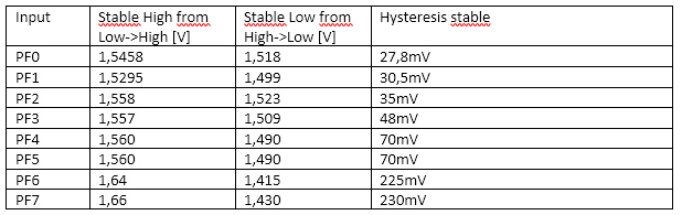

VolkerKugler
I tried to measure directly at the pins PF0 to PF7 of a nucleo STM32F767ZI to get a better idea of the real situation.
What I can see is, that PF0 to PF5 toggle extremly when starting at 0V and turn up the voltage slowly. They start toggeling at 1,50V. From High to Low they start toggeling at 1,55V. PF6 and PF7 don`t toggle and they have a hysteresis which is not lower than 100mV.
Here the measured values:
As you see, the 10%VDD Hysteresis (VDD = 3,13V) does not exist on 6 of the 8 pins.
Best regards
Volker
