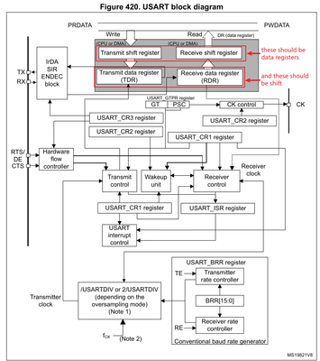

In RM0351 Reference manual Figure 420. USART block diagram, the positions of shift registers and data registers (of both Transmit and Receive) are wrong; their positions should be swapped.
STTwo-32
Hello @embed_elephant and welcome to the ST Community :smiling_face_with_smiling_eyes:.
I confirme the issue on the diagram. I've escalated to the concerned team for correction (Under internal ticket number 178365).
Thank you for your contribution.
Best Regards.

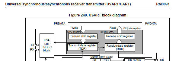

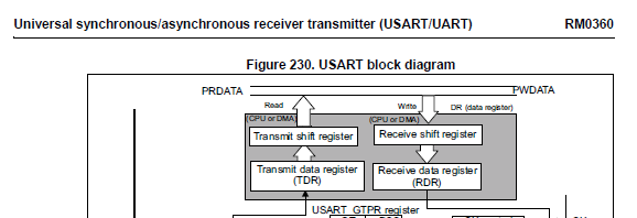

Looks like the same mistake is repeated in many RMs; eg,
Hello @Andrew Neil
We will check other RMs too. And we will be grateful for all your contributions.
