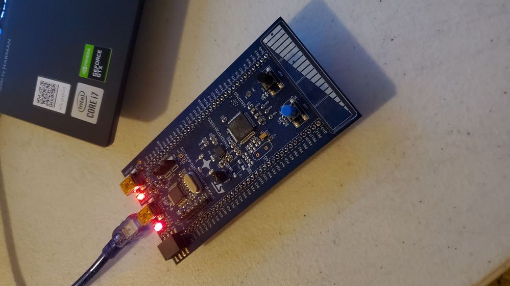

Here's my setup. Pretty basic, just trying to get this part to work before moving on.
0693W00000KbVGPQA3.jpgDo I need additional hardware to make this work? Do I need to connect to the other micro-usb slot? (actually just tried that and it didn't seem to work when I plugged it in).
Are the setting I chose the right ones?
The "USB USER" port is connected to the target chip, so yes, you need to use that one. The "USB ST-LINK" is connected to the ST-Link chip.

Alright so yes it's been a while since I've looked at this problem again because it was frustrating me. I tried your suggestion once before that I needed to use the usb user connection, but it hadn't worked. Today I again just tried to enable the USB as Device (FS), and then the USB_DEVICE as Communication class VCP, and then connected to the usb user connection on the board and it worked. I remember doing that before, but now it's April so it makes sense that it works now, you know how it goes :face_with_tears_of_joy:

The STM32 F0 Discovery board has TWO MINI USB connectors, one connected to the ST-LINK/V2, that doesn't support a serial port, that's a later ST-LINK/V2-1 design feature.
The USER USB connects to the STM32F0 part, that need you to build a USB CDC/VCP DEVICE, depends on the F0 to have a viable USB port and appropriate software load.
