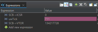

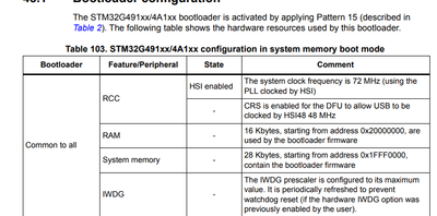

WHile debugging for a custom board this is what I am facing Break at address "0x1fff4080" with no debug information available, or outside of program code.
This is the code that I am trying to run . What is the reason for this error and how it can be curated .  I have already verified the most common reason i.e. BOOT0 pin which has been pulled low.
I have attached the main.c file to this post

Register values can be viewed when debugging in the SFRs window. Window -> Show View -> SFRs or by adding them as expressions. For example, when your code is paused, add "SCB->VTOR" as an expression.

It starts as soon as I enter superwhile at time of debugging. I have already attached the main.c file

Looks like it's in the bootloader.
Is BOOT0 tied low?

In your system file, uncomment this line:
/* #define USER_VECT_TAB_ADDRESS */
 so it looks like this:

Thankyou It solves the issue I was having
