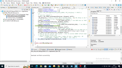

When ever i am trying to copy data in SDRAM garbage value is getting transferred. Please suggest what can i do
I have attached necessary files with this post.
Kindly suggest.

Thank you for your reply.But i have narrowed down the problem.i found out that while initalizing SDRAM with FMC i have written following code.
void FMC_INIT(void) {
HAL_StatusTypeDef status;
/* Step 1 and Step 2 already done in HAL_SDRAM_Init() */
/* Step 3: Configure a clock configuration enable command */
Command.CommandMode = FMC_SDRAM_CMD_CLK_ENABLE; /* Set MODE bits to "001" */
Command.CommandTarget = FMC_SDRAM_CMD_TARGET_BANK2 ; /* configure the Target Bank bits */
Command.AutoRefreshNumber = 3;
Command.ModeRegisterDefinition = 0;
/* while (FMC_GetFlagStatus(FMC_Bank2_SDRAM, FMC_FLAG_Busy) != RESET) {
/* Send the command */
status = HAL_SDRAM_SendCommand(&hsdram1, &Command, 0xfff);
HAL_Delay(1); /* Step 4: Insert 100 us minimum delay - Min HAL Delay is 1ms */
/* Step 5: Configure a PALL (precharge all) command */
Command.CommandMode = FMC_SDRAM_CMD_PALL; /* Set MODE bits to "010" */
/* Step 6: Configure an Auto Refresh command */
Command.CommandMode = FMC_SDRAM_CMD_AUTOREFRESH_MODE; /* Set MODE bits to "011" */
Command.AutoRefreshNumber = 2;
/* Step 7: Program the external memory mode register */
Command.CommandMode = FMC_SDRAM_CMD_LOAD_MODE;/*set the MODE bits to "100" */
Command.ModeRegisterDefinition = (uint32_t)0 | 0<<3 | 2<<4 | 0<<7 | 1<<9;
/* Step 8: Set the refresh rate counter - refer to section SDRAM refresh timer register in RM0455 */
/* Set the device refresh rate
* COUNT = [(SDRAM self refresh time / number of row) x SDRAM CLK] – 20
= [(64ms/4096) * 100MHz] - 20 = 1562.5 - 20 ~ 1542 */
HAL_SDRAM_ProgramRefreshRate(&hsdram1, 733);
But unable to change command mode value after sending commands.
‎2024-01-04 05:33 AM - edited ‎2024-01-04 06:35 AM
Hello @Rushali ,
--> unable to change command mode value after sending commands.
Thank you for bringing this issue to our attention.
After checking, I confirm that the MODE Bits read as zero after the command is issued and this is normal behavior.
The MODE bits are write only. For that I reported the reference manual internally for correction.
Internal ticket number: 169917 (This is an internal tracking number and is not accessible or usable by customers).
Thank you.
Kaouthar
