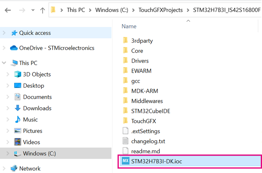

2.1  Open the STM32CubeMx project
Under the project location, open the STM32CubeMx project by double-clicking on STM32H7B3I-DK.ioc

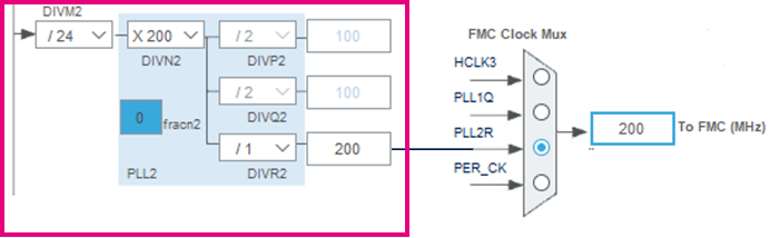

­­­2.2 Set up the FMC clock

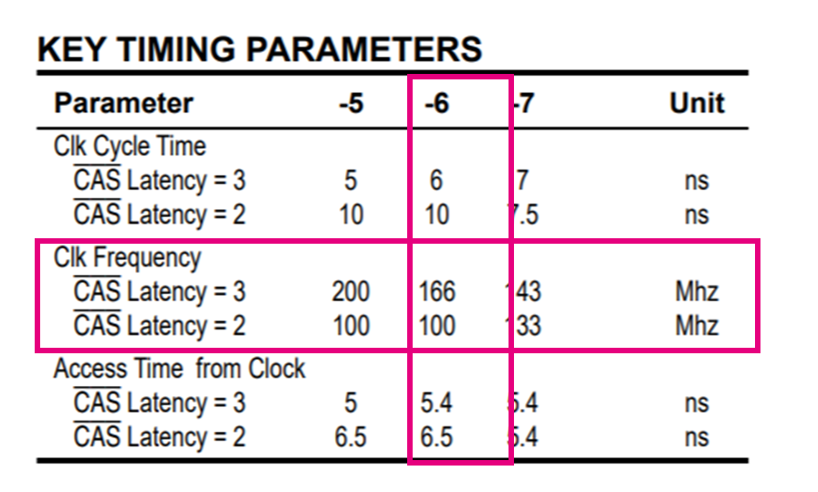

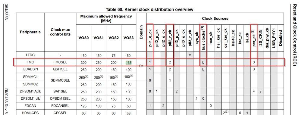

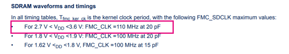

When we look at the SDRAM datasheet, we see the max clock of the SDRAM depends on the Column Address Strobe CAS latency. For our SDRAM, “-6” variant, the CAS latency can be set to 2 and the max clock frequency would be 100MHz and could be set to 3 clock cycles and the max clock frequency would be 166MHz.
On the other side, when we look at the STM32H7B3LI datasheet, we see the maximum FMC clock at VDD = 3.3V is 110MHz.
In this article we’ll use the FMC clock frequency (which is the clock that will feed the SDRAM) at 100MHz and the CAS latency to 2.
The first step is to setup the clock to the FMC peripheral. Here we will use PLL2 to set it to 200MHz. We’ll see later that the SDRAM clock is derived from this FMC clock and using 200MHz you can get up to 100MHz as clock frequency for the SDRAM with the divider set to 2.
In STM32CubeMx, under the Clock Configuration Tab, we see the FMC clock mux. As shown below, the FMC clock is derived from PLL2. Thus, we need to set up the DIVM2 and PLL2 “N” multiplier, “R” and the divider right after the output of the PLL2 in a way to get 200MHz to the FMC.
One possible solution is to have DIVM2 = 24, N = 200, R = 1. This solution gives an FMC clock of 200MHz. This clock will get divided by 2 later in the FMC – ref. “SDRAM common clock”

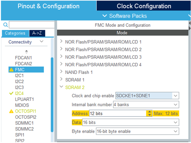

2.3 Set up the SDRAM

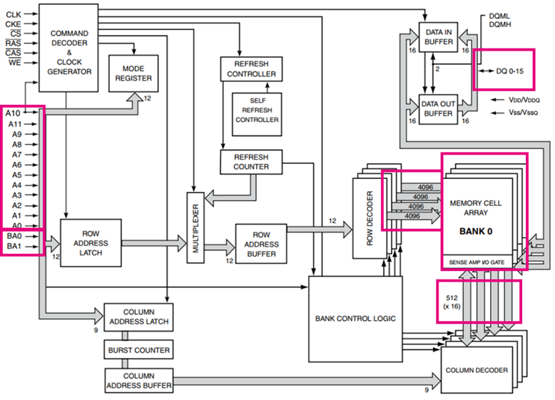

The SDRAM IS42S16800F-6BLI has the following main features:
  • 4096 rows by 512 columns
  • 4 banks
  • 12-bit address: A0…A11
  • 16-bit data: D0…D15
  • Self-refresh time = 64ms

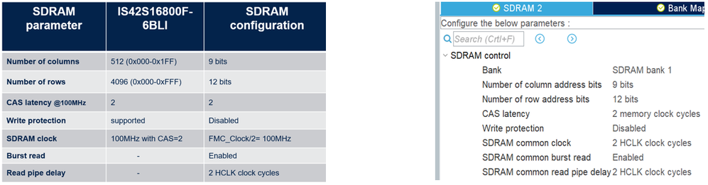

The FMC can support up to two SDRAM banks: SDRAM1 and SDRAM2 256Mbit each. SDRAM1 is mapped at the address 0xC000 0000 and SDRAM2 is mapped at address 0xD000 0000. The SDRAM on the STM32H7B3I-DK Discovery Kit is connected to the SDRAM2 interface. As you can see in the schematic below, the SDCKE1 signal is connected to the SDRAM clock input and SDNE1 is connected to the chip select/enable input.
As shown above by the block diagram of the SDRAM IS42S16800F-6BLI, the memory has 4 banks, 12 bits of address, 16 bits of data and 16-bit byte enable. All we need to do is to provision the SDRAM characteristics as shown below:
The next step is to setup the following parameters:
  • Number of columns: we need 9 bits to code the 512 columns. In STM32CubeMx, we need to set the number of column address bits to 9 bits.
  • Number of rows: we need 12 bits to code the 4096 rows. In STM32CubeMx, we need to set the number of row address bits to 12 bits.
  • CAS Latency: The CAS latency is 2 at 100MHz. In STM32CubeMx, we set the CAS latency to 2.
  • Write protection: We will disable the write protection.
  • SDRAM clock: The SDRAM maximum clock frequency is 100MHz at CAS latency of 2. In STM32CubeMx we set the divider to 2. This gets us an SDRAM clock of FMC clock divided by 2 meaning 200MHz/2=100MHz.
  • We’ll enable the burst read for single read request and set the pipe delay to 2 clock cycles.

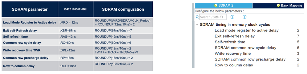

611.png2.4 Setup the SDRAM timings

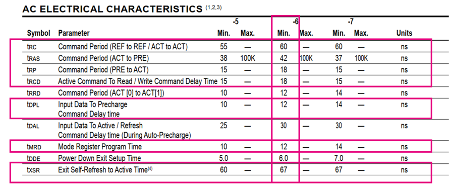

The datasheet of the SDRAM IS42S16800F-6BLI specifies a set of timing values in which some of them need to be provisioned in STM32CubeMx such as tRC, tRAS,….:
  • We’ll start with the load mode register to active delay (tMRD) which indicates the delay between the load mode register command and the row or refresh command. The memory datasheet specifies 12ns which needs to be converted to a number of memory cycles. So, we divide the 12ns by the SDRAM clock period which is 10ns and then we round to the upper value and is the value we use in STM32CubeMx.
  • Second, the exit self-refresh delay (tXSR)is the Exit self-refresh to delay between valid commands. The memory datasheet specifies 67ns and is converted to 7 SDRAM clock cycles and is the value we use in STM32CubeMx.
  • Third, the self-refresh time defined (tRAS) is the Delay between line valid and precharge command. The memory datasheet specifies 42ns and is converted to 5 SDRAM clock cycles and is the value we use in STM32CubeMx.
  • After that, the common row cycle delay (tRC) is the Delay between two refresh commands or two lines of valid commands. The memory datasheet specifies 60ns and and is converted to 6 SDRAM clock cycles and is the value we use in STM32CubeMx.
  • Next, the write recovery time (tDPL) is the Delay between writing a command to a precharge command. The memory datasheet specifies 12ns and when we convert it to SDRAM clock cycles we get 2 while the specification of the STM32 requires having TWR >= TRAS – TRCD=5-2=3 and that’s the value we use in STM32CubeMx.
  • After that, the common row precharge delay (tRP) is the Delay between precharge and line valid commands. The memory datasheet specifies 18ns and when converted is 2 SDRAM clock cycles and that’s the value we use in STM32CubeMx.
  • The Last parameter is the row to column delay (tRCD) and indicates the delay between the line valid command and the read/write command. The memory datasheet specifies 18ns and is converted to 2 SDRAM clock cycles and that’s the value we use in STM32CubeMx.

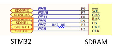

2.5 Setup the GPIO
Finally, we select Under GPIO settings Tab, we see that the STM32CubeMx default pinout for SDRAM matches the STM32H7B3I-DK schematic except for the following pins: FMC_SDCKE1SDCKE1, FMC_SDNE1, and FMC_SDNWE
  • STM32CubeMx selects PB5 for SD clock enable 1 by default while the schematic uses PH7
  • STM32CubeMx selects PB6 for SD chip enable by default while the schematic uses PH6
  • STM32CubeMx selects PC0 for SD write enable by default while the schematic uses PH5
Hence, we need to change the mapping of FMC_SDCKE1, FMC_SDNE1 and FMC_SDNWE to match the STM32H7B3I-DK schematic.
In the pinout view tab, type the name of the pin in the search field, the pin will be highlighted, left click on the pin and change the alternate function to SDRAM signal. The example below shows how to change FMC_SDCEK1 to PH7.

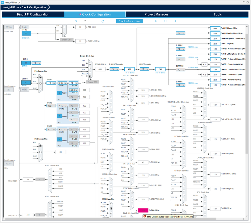

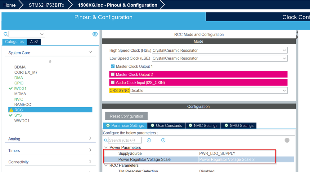

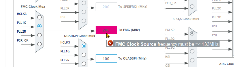

Thank you for this helpful article. However with STM32CubeMX Version 6.10.0 and 6.11.1 I get an error (FMC Clock Source frequency must be =< 133 Mhz) when FMC Clock Source is configured to be 200 MHz which was allowed in previous versions of CubeMX.
CubeMX FMC Error with STM32H753CubeMX FMC Error with STM32H753
Is this a bug in CubeMX?
dmarks-ls
May 23, 2024
@bbee You may be better off creating a new topic, I'm not sure that ST will reply here.  However, I'm unable to reproduce your issue.  I'm using the latest IDE (1.15.1) and the latest STM32 FW H7 (1.11.2), and the tool tells me (in my present config) that my max FMC clock is 300 MHz.
STM32H753, FMC w/ SDRAM selected, overclocking FMC to show max 300 MHzSTM32H753, FMC w/ SDRAM selected, overclocking FMC to show max 300 MHz
It is entirely likely that the flagged maximum value of the FMC input depends on what mode(s) you are operating the FMC in.  For SDRAM mode, you can feed 300 MHz to the FMC, then the FMC will internally divide that down by up to div/3 to yield a 100 MHz memory clock.  I'm guessing you've selected a memory mode or type that has different restrictions on what fmc_ker_ck frequency can be selected.  If you do create a new topic on this, @ tag me, and I'll see if I can help further.  (I can't attach an .ioc or .zip file here.)
Dana M.
bbee
Senior
May 24, 2024
@dmarks-lsThank you for your response.
In the meantime I managed to figure out the reason by myself. The maximum allowed frequency for FMC depends on the selected Power Regulator Voltage Scale. In my Project I selected VOS3 for which the maximum allowed frequency is 133 Mhz. CubeMX knows it, but gives no hint related to the power parameter. I switched to VOS2 which allows a maximum of 200 Mhz.
