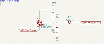

Currently  i'm remaking a new version of my card, because, the debug connection in my first card wasn't effecient. For my new card, i drew inspiration from existing circuit for SWD and i just add a connector 6 Pins. I'm here to know if my new schematic is good or not.

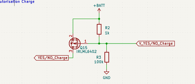

And now, @mƎALLEm found another probleme with this part of the circuit:
So i change the circuit with adding a zener and a 20k Resistance:
and i want to know if it's correct ? And if i have to change other part of my global schematic ?
