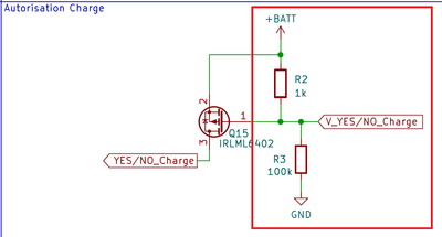

Hello, i have a new version of my Shematic for my project, can you give me some feedbacks please ?
Yassir
I'm not very comfortable with this part: PB3 connected to +BATT (12V?) via a resistor bridge 1k/100k!
In my opinion there will be a risk of important current injection and voltage exceeding VIO input max!
Did you make the calculation on that point (V_YES/NO_Charge)?

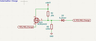

Me too, i didn't notice this, it's a mistake. I think 20k/100k would be better (+BATTmax = 15V).
What do you think ?
In my opinion need to find a solution to isolate the battery voltage from the MCU. May be by using optocoupler?
I want to charge my battery with my alternator, so they need to be on the same potentiel. And i want to pilot the charge with my MCU ("Autorisation charge" + Contacte charge batterie").
Do you think that i can isolate the battery voltage from the MCU ?
In my opinion you need to isolate your MCU from the alternator/battery circuitry ..
So i must have to use VDD and not +batt ?
Hi, do you think that if i add a Zener it will be enough to protect the MCU here ?

@yassir wrote:
+BATTmax = 15V
That might be the highest nominal voltage, but spikes & glitches can cause much higher transients than that -, eg, do a search for "load dump" ...
