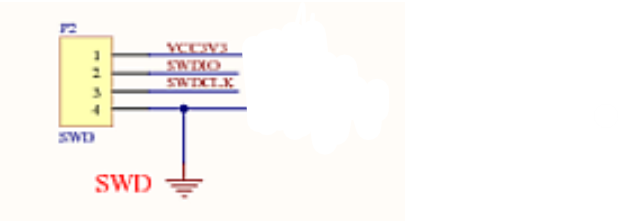

For my HW, I have this, is it correct ?
That's a very poor image - hard to read what the text says.
And it tells us nothing, as it doesn't show where those lines actually go!
It's best to include NRST on the programming/debug header - this can get you out of some "stuck" situations...

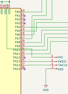

Sorry i'm fresh and new developer ! This is my schematic. These pin are connected to Pin header, in my PCB.
What's going on here?
It looks like you've only connected pin 36 of the STM32 to pin 1 of the programming connector?
All of your VDD pins need to be connected together!
Again, as @mƎALLEm has repeated a couple of times, you really need to study the AN4488 Application Note!
You should also look at the ST Dev Board schematics as examples ...
Sorry but i never hered something about the AN4488 and here a I see that it stuck me in my developement. I have to connect all VDD together but i also have toconnect all my GND together or not ?

@yassir wrote:
 i also have to connect all my GND together or not ?
Yes.
