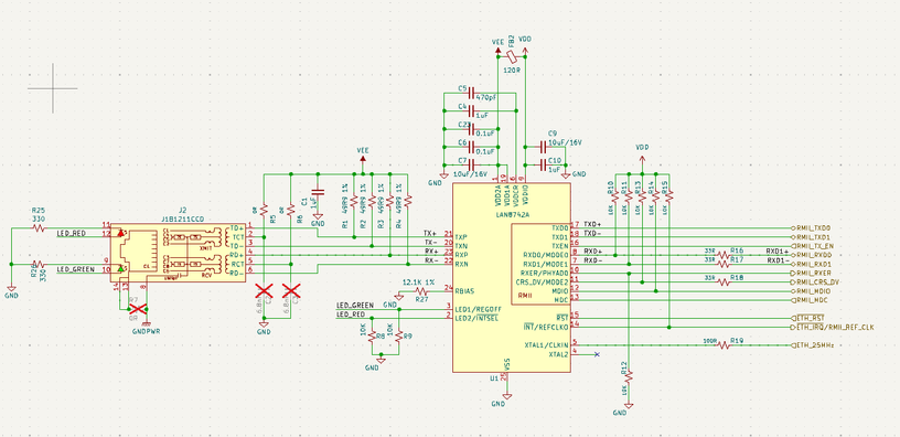

I'm working on a project involving FreeRTOS, lwip, and Ethernet with the ST32H563VGT6 MCU on a custom PCB.

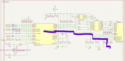

I'm attaching the hardware schematics, which we've taken from ST's schematics of the NUCLEO-H563ZI board. I'm including a PDF with the schematics distributed by ST.
The schematics of my board are shown below:
In previous versions of the custom board, we used a different hardware design:

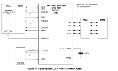

We decided to switch to ST's schematics for greater robustness. The first configuration we tried, shown in the second image, is characterized by the lan8742 clock coming from the MCU's output clock (MC0), and the RJ45 connector comes with built-in magnets. Additionally, it does not include the USBLC6-4SC6 integrated circuit for ESD protection.
The second configuration, corresponding to the first image, uses ST's schematics, which we imported identically to the ST version of the NUCLEO-H563ZI.

We've even attempted a bypass, avoiding the use of the LAN8742 crystal (trying to replicate our first design which works) and relying solely on the MCU.

However, if you look the schematics, you will see that there is already a pull down resistor on pin 2 (LED2/nINT/nINTSEL).
therefore, the reset should be performed correctly, right?
Should i change the value of the strap?

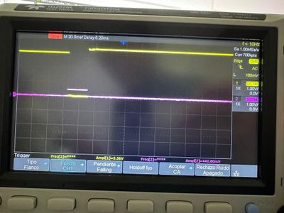

Good morning, Jan.

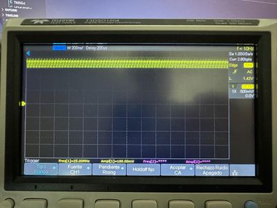

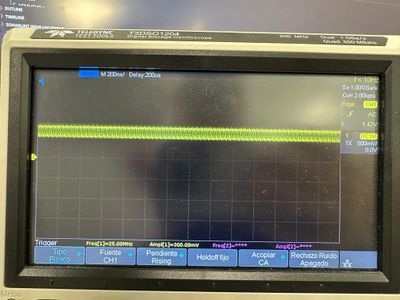

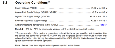

We've encountered an issue regarding the absence of a 50 MHz clock output on the RMII_CLK_REF. Instead, we're measuring a voltage range of 1.9 to 2.1 V at the VDDCR pin, whereas it should ideally be 1.2 V according to the datasheet. In our previous design and on the NUCLEO BOARD, the output reads 1.2 V as specified. As evident from our pictures, we're utilizing the internal Voltage Regulator (with REGOFF internally pulled down). This deviation from the expected VDDCR output voltage seems to be the root cause of our design issue. Although the crystal oscillator is functioning correctly, it appears to have a greater DC offset compared to the Nucleo Board. Comparison of LAN8742 crystal output:
  • NUCLEO Board:
  • Our Second Design:

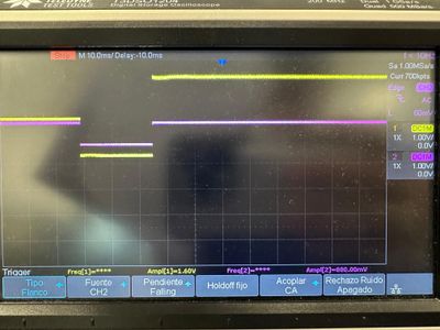

Furthermore, we've observed that the nINTSEL pin is not performing as expected. During a reset period, the behavior differs between the NUCLEO and our second design. On the NUCLEO, the GPIO pin transitions from high to low for 25 ms before going back to high to initiate the reset. Conversely, on our design, the nINTSEL pin exhibits inconsistent behavior, with the GPIO pin initially at 1.2V before initialization, and the output of the nINTSEL pin deviating from its expected behavior.
Comparison of LAN8742 nINTSEL output:
  • nINTSEL OUTPUT from NUCELO
  • nINTSEL OUTPUT from our second design:
Similar irregularities are observed with the REGOFF pin.
We suspect that these issues may be related to the malfunctioning of the internal regulator, resulting in incorrect VDDRC output.
We've thoroughly reviewed both digital and analog voltages, and they appear stable and within the specified range, except for the Ethernet Magnetics Supply Voltage (we don't know how to measure it)
Your support and assistance in resolving these issues are greatly appreciated.

waclawek.jan
Hi Maxim,
I'm by no means expert on the PHY. You may perhaps try to talk to SMSC/Microchip.
Meantime, as I've said above, check connections of all VCCs and GNDs of the PHY, including the middle tab.
massimoperdigo
Ok, thank you.
Yes, I did it and all seems correct except for the VDDCR pin.
I will contact microchip support.
Hi JW!
i forgot to mention it, but there was a problem with the PCB… the GND of the LAN chip was not connected property.
what a silly error!
thank you for your support!!!
