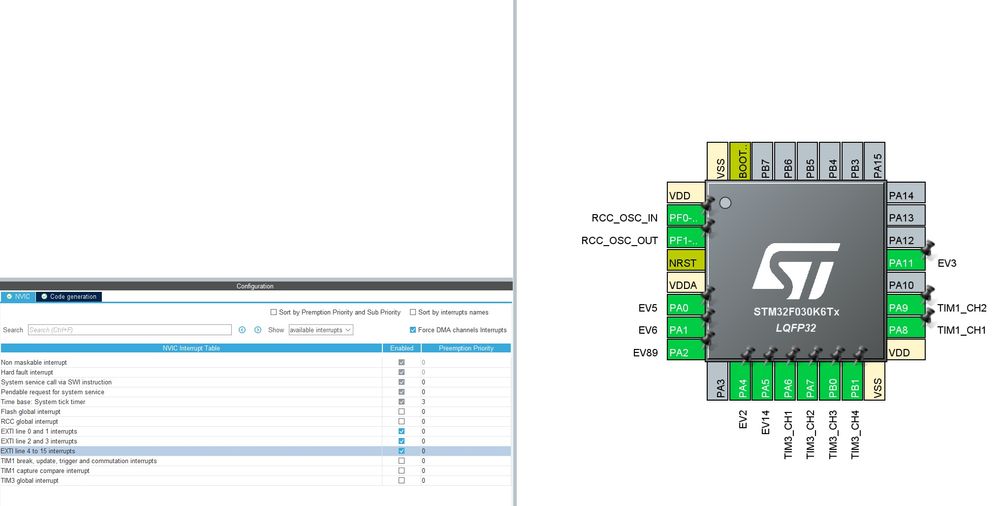

STM32F030K6 _ external interrupt just 1/3 EXT line is function
Johan_mecatronique
I try to use 6 external interrupts but only EXT4_15 is functionning. All is functionning correctly when i use HAL_GPIO_ReadPin() function without interrupts.
Thank you for your HELP
void EXTI0_1_IRQHandler(void)
  /* USER CODE BEGIN EXTI0_1_IRQn 0 */
  /* USER CODE END EXTI0_1_IRQn 0 */
  HAL_GPIO_EXTI_IRQHandler(EV5_Pin);
  HAL_GPIO_EXTI_IRQHandler(EV6_Pin);
  /* USER CODE BEGIN EXTI0_1_IRQn 1 */
  /* USER CODE END EXTI0_1_IRQn 1 */
  * @brief This function handles EXTI line 2 and 3 interrupts.
void EXTI2_3_IRQHandler(void)
  /* USER CODE BEGIN EXTI2_3_IRQn 0 */
  /* USER CODE END EXTI2_3_IRQn 0 */
  HAL_GPIO_EXTI_IRQHandler(EV89_Pin);
  /* USER CODE BEGIN EXTI2_3_IRQn 1 */
  /* USER CODE END EXTI2_3_IRQn 1 */
  * @brief This function handles EXTI line 4 to 15 interrupts.
void EXTI4_15_IRQHandler(void)
  /* USER CODE BEGIN EXTI4_15_IRQn 0 */
  /* USER CODE END EXTI4_15_IRQn 0 */
  HAL_GPIO_EXTI_IRQHandler(EV2_Pin);
  HAL_GPIO_EXTI_IRQHandler(EV14_Pin);
  HAL_GPIO_EXTI_IRQHandler(EV3_Pin);
  /* USER CODE BEGIN EXTI4_15_IRQn 1 */
  /* USER CODE END EXTI4_15_IRQn 1 */

  HAL_NVIC_SetPriority(EXTI4_15_IRQn, 0, 0);
  HAL_NVIC_EnableIRQ(EXTI4_15_IRQn);
Looks like these lines are missing for EXTI0_1 and EXTI2_3.

1. [Part Number] STM32F030K6T6
2. [Environment] STM32cubemx6.14.1 + STM32CubeIDE Version: 1.18.03.
3. [Schematics] See the screenchot above. It's custum board.  All is functionning correctly when i use HAL_GPIO_ReadPin() function without interrupts.
4. [Details] only EXT4_15 is functionning.
5. [Expected behavior] all external interrupts  needs to be OK
6. [How to reproduce] Inputs are configured with pull-up resistor  and Rising/Falling edge detection
I've done a quick test. It seems to be the good way : now all is functionning except EV5 (PA0_Pin). I will do more verification tomorow.
Thank you
That's not a schematic - that's just the CubeMX pinout.
That tells us nothing about the external hardware & connections.
You need to show the schematic of your board - ie how the STM32 is connected to the rest of your system.
Johan_mecatronique
Thank for your Help!
All ISR are functioning  now
