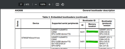

If Systembootloader Doesnt detect anything comming from any peripheral, does it timeout and jump to 0x8000000?
Because by reading AN3154 , it looks like it does, but when im trying with my stm32f405RE it doesnJavier1_0-1737476993543.png

MM..1
Chief III
Primary move your jump before hal init. Secondary address you use isnt ok. Here is ID if loader not start.
AN2606 try 1fff0000
The memory location is what AN2606 says
so
0x1FFF77DE
should be alright.
You were right for some reason 0x1FFF0000 is the actual address

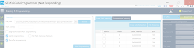

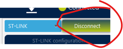

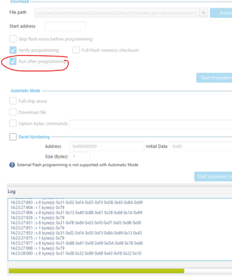

It doesnt jump from Systembootloader to 0x80000000 even if im using cubeProgrammer and selecting "Run after programming" option, i am able to execute my blinky code only after a Power reset or button Reset.
If "run after programming" is selected im not able to "Disconnect" without Cubeprogrammer crashing
