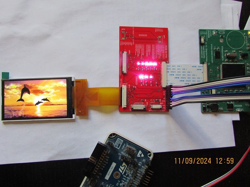

does anybody have source code for LG4571 display (480 x 800)
MNapi
Senior III
there is nothing on  github.
there is initialization by SPI before the LTDC works
is there a sequence like you initialize it first over SPI then
MX_LTDC_Init() or it does not matter
I do have the initialization code but I am missing something
