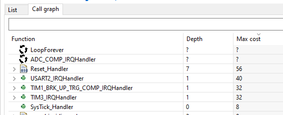

Hello, I am using STM32G030F6Px, it has 32 KB flash memory and I need free space to save data in flash, also it needs to have bootloader. That's why I decided to use bare metal code instead of HAL library, of course I did this by examining HAL libraries. I could set system clock to 64 MHz, also I could use UART with interrupts, timers with interrupts and PWM. Until this point I was successful, 15 KB library code became 2.5 KB. Then I tried to add ADC with DMA. I created this "uint32_t adcValues[2]" variable and gave it to DMA. I put breakpoint in DMA1_Channel1_IRQHandler but it never comes here in the debug session. When I suspend it in anywhere else I see I can get correct analog values from "adcValues[2]". I did same project with HAL libraries and in there DMA1_Channel1_IRQHandler gets triggered. In the debug session I compared the registers and its all same. I set Bit 4 OVRIE: Overrun interrupt enable for ADC->IER, Bit 3 TEIE: transfer error interrupt enable, Bit 2 HTIE: half transfer interrupt enable, Bit 1 TCIE: transfer complete interrupt enable for DMA->CCR1, also I set NVIC bit for DMA1_Channel1(DMA1 channel 1 interrupt). As I said before register values are same for ADC, DMA, DMAMUX. How can I make DMA1_Channel1_IRQHandler is getting triggered? Sorry for this question with long history, I tried to explain why I cant use HAL libraries.

Thank you for your reply. I checked first 4 of your advices and those are all correct but I have problem with the last one. I created this project in STM32CubeIde and it provides linker and startup files. There is a section like below in the startup file, and code stuck in there.

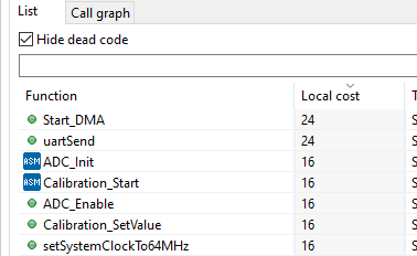

I couldn't realize that infinite loop is not my for loop in the main. Its my bad sorry. This pictures are from stack.
0693W00000HrYmmQAF.png0693W00000HrYnaQAF.pngI dont have ADC_COMP_IRQHandler, should I have? I checked the project that is created by STM32CubeMX with HAL libraries and it doesn't have ADC_COMP_IRQHandler.
I created something like this and handled interrupt flag0693W00000HrYysQAF.png
it still goes to infinite loop but this time from different place.0693W00000HrYzMQAV.pngits this
