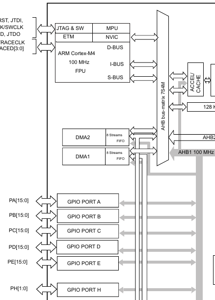

surprise, surprise : the H7 is a super fast core - but not fast on port access.
this is because the ports are "far away" from the core on a "slow" bus .
look at an F4, i tried the F411 at 100MHz core clk, producing a 10ns pulse on port pin (BSRR...) ; with optimizer on speed (-Ofast) , without optimizer get about 50ns .
here ports are "close to core" on AHB1 :

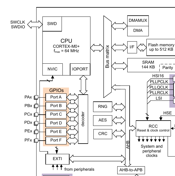

or on a new M0+ core , ports direct to core (but cannot accessed by DMA here ! )

First, the maximum GPIO port output speed is 100 MHz, which is way below the maximum CPU clock frequency which may be a bottleneck for your application.

@AScha.3​, please, would you consider attaching references for your screenshots for better visibility?
Thank you,
Firas
To give better visibility on the answered topics, please click on "Best answer" on the reply which solved your issue or answered your question.Best regards,FBL
AScha.3
March 13, 2023
@F.Belaid​  i add diagram title...ok?
