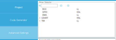

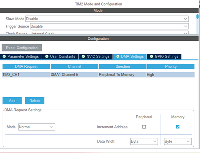

Klassic_0-1718361144991.png           DMA Req setting: >Mode: Normal.

As you know there's no Mem to Mem option available in recent cubeMx. Only Periph to Mem Or Mem to Periph. I read somewhere that Periph to Mem is same as Mem to Mem. plz correct me.
According to AN4666 doc, DMA1Ch5 was selected using Tim2Ch1. And I did the same.

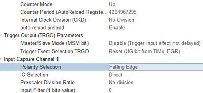

For timer in Inp capture, I am using falling edge to trigger DMA.

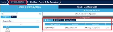

Hi  @SofLit
   Tried DMA in MEM to MEM mode and triggered it thru software. And chose DMA2 for it. Still the DMA transfer happens only once during start up.
 Also, the mode is set to Normal instead of circular , since, according to RM, it cannot be set to Circular in Mem to MEM mode.
