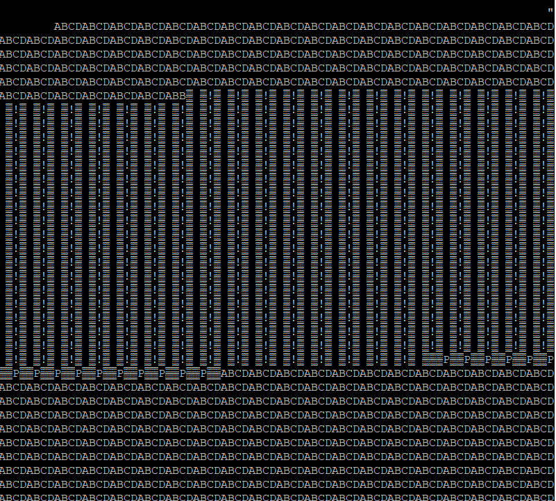

I'm using two STM32F4 nucleo boards and my goal is to transmit data unidirectionnaly from one board to another using SPI in a loop.
The first board is configured as a Master and it only transmits data. And the second one is configured as a Slave and it only receives data.
The data is set to "ABCD" and it does not change during the test.
The data is transmited without any problem. I checked it using an oscilloscope.
However, the problem is that I receive the correct data only during a certain amount of time and the data is alterd after some itteration. Here is some output of the data on my PuTTy console.
Data captured from PuTTyData captured from PuTTy

> uart_buf_len = sprintf((char *)uart_buf, "%s", RX_Buffer);
RX_Buffer is not null terminated. This leads to a potential overflow and undefined/bad behavior.
Perhaps copy over the 4 characters and send exactly those.
Otherwise code seems okay.
Thank you for your response
I changed the code with the following one, but I still got the same problem
