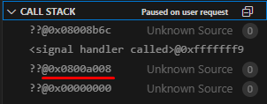

Sorry I meant its stuck in somewhere, is it possible to debug application code when using bootloader? I tried with bootloader now and I saw this error:
which means its in Hard Fault handler:

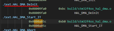

When I check call stack I see:
It fails in HAL_DMA_DeInit function. I was calling this function before initialization of DMA. I removed it.

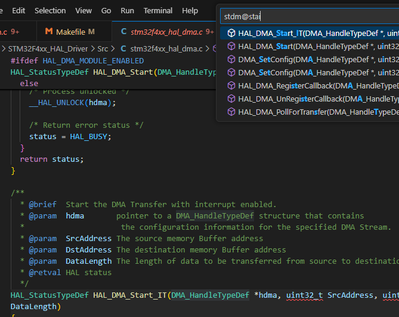

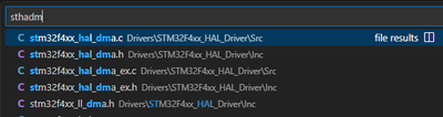

Sure CubeIDE finds files. In VS Code when you want to open a file, you are not writing whole file name, only a few letters is enough:
Then you can see outline by writing @ character and open fuction directly.
With one click you can see the list of commits which changed the file you are working on, and you can compare current status of file with any of those commits. I can admit VS Code is more suitable for lazy guys :).
