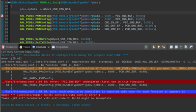

I'm currently working with the classic core MW repository. There is a problem. In the function USBD_LL_Init(), in usbd_conf.c , there are functions that are not compliant to STM32N6 like HAL_PCDEx_PMAConfig. How do I replace them. This is the only error, that I get from the IDE. Also, there are some definitions from the example like PCD_SNG_BUF and CDC_IN_EP that are not defined anywhere. Can you help?
Thanks

can you please share with us a caption of the problems window from your CubeIDE to see the full error that you are getting?
About that, STM32N6 unlike the STM32F4 you used to work with is not embedding USB device controller to use Packet Memory Area! The STM32N6 embeds USB OTG controller. So we use FIFOs instead of PMA.
To learn more refer to these articles:
How to configure USB FIFO over USB OTG controller
How to configure the packet memory area in STM32
About
> But still, I need to know what went wrong with the classic CDC example.
If still having issues, I suggest you to start a new discussion and point directly to the issue and provide better about your application (HW and SW) so we can help you further.
