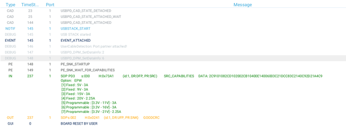

The problem I'm facing is the following:
I have a custom PCB that I designed. Currently, it just has blinking lights.
When I connect the PCB to a USB-PD capable power source, the PCB start with blinking lights. After around 500ms-1s, the blinking freezes (indicating that the MCU froze) for about 1s. Then, it resets.
To me, it seems that the SRC gives power -> MCU freezes -> SRC takes away power -> SRC reapplies power.
I receive events 2 & 6 in USBPD_DPM_SetDataInfo(), but I never receive any events in USBPD_DPM_GetDataInfo().
You can see that the source sends SRC_CAPABILITIES with EMB_TRACE. But this is never received by any callbacks on the MCU.
Am I missing something? How can I start debugging this configuration?
Thanks for your help!
Attached you can find the whole trace
I was able to fix it by setting LIBRARY_MAX_SYSCALL_INTERRUPT_PRIORITY from 5 to 3 in FreeRTOS config.
As pointed out here
