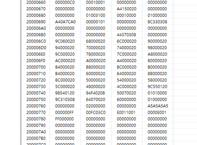

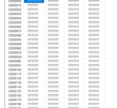

Additionally, after debugging and inspecting the memory, I can see the values written to the internal RAM, but I cannot see any values written to the SDRAM.

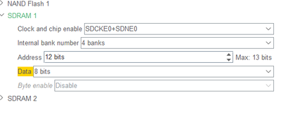

The SDRAM model I am using is the MT48LC4M32B2B5-6A_IT. I will attach an image showing the parameters I set in CubeMX.

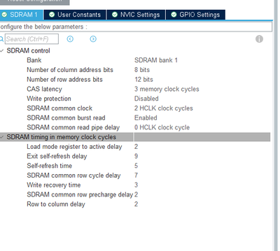

To provide some details, the system clock is set to 216MHz, and the data width is 8 bits because the environment only supports an 8-bit configuration. The CAS Latency is set to the maximum performance of the SDRAM, and the SDRAM common clock is set to 2, resulting in 216/2 = 108MHz, which I intended to ensure would not cause issues.
At 108MHz -> 9.26ns
- tMRD = 12ns / 9.26ns = 1.29 -> 2 clock cycles
- tXSR = tRFC + tRP = 78ns / 9.26ns = 8.42 -> 9 clock cycles
- tRAS = 42ns / 9.26ns = 4.54 -> 5 clock cycles
- tRC = 60ns / 9.26ns = 6.48 -> 7 clock cycles
- tWR = 12ns / 9.26ns = 1.3 -> 2 clock cycles
- tRP = 18ns / 9.26ns = 1.94 -> 2 clock cycles
- tRCD = 18ns / 9.26ns = 1.94 -> 2 clock cycles
I have configured the settings accordingly.
I would appreciate your assistance in resolving the issue.

I apologize for the confusion. I am currently using the STM32F746 chip and the SDRAM MT48LC4M32B2B5-6A_IT. My development environment is STM32CubeIDE.
I have referred to this link to configure the SDRAM, but I am encountering issues and would appreciate your assistance.
