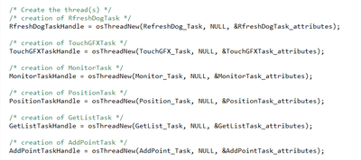

I’m developing a GUI using TouchGFX on the STM32F469I-DISCO board.
In the handleTickEvent() function, I add 5 points to a dynamic data graph each time it is called. However, when doing this, the frequency of handleTickEvent() drops significantly, and the display performance becomes very poor.

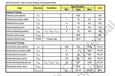

In comparison, an older project based on the demo uses MIPI DSI in command mode and configures LTDC as 480×200×4, and it performs noticeably better than my current setup where LTDC is configured as 480×800 and DSI is set to video mode.
The scan is 480 * 800 .

Other than that, your LTDC is not set up according to your table, which may be the reason you only see 40 fps when not adding points to the graph. What you want is this:
And an LTDC clock of 26.37 MHz. If you cannot get that clock, you can lower the porches as long as they are above the minimum values specified in your table until the timing is right.

    1. I've uploaded the data manual of the screen. If in dsi-video mode , the results you obtained using the NT35510 are the same as mine.
    2. second requires adding 50 - 100 points to the graph. I need to ensure 25 fps (In the DSI - command mode, the 25 fps screen is relatively smooth. However, in the DSI - video mode, the 25 fps screen still flickers. I think the actual screen fps should be higher to ensure no flickering), which means adding at most 2 - 4 points each time.
    3. I did another test and upload video. Do nothing after initializing the graph
    4. I'll think it over carefully according to your reply. Can I get your demo?
    5. What about the graphics display performance of  STM32U5  (GPU2D + DMA2D) or the STM32F7 (DMA2D) development boards if using the DSI - video mod driver for a 480*800 - resolution screen?
