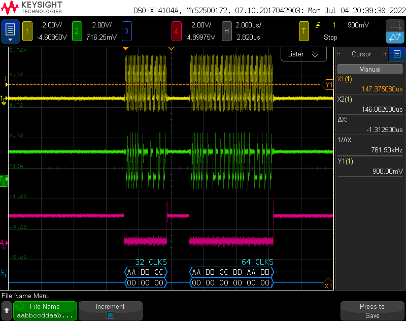

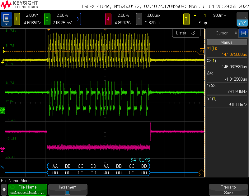

when I'm running a single SPI transaction using
HAL_SPI_TransmitReceive i have different behavior with different payload size:
when i am use samll payload = "aabbccddaabbccdd" then i get the following:
but when i am using larger payload = "aabbccddaabbccddaabbccdd" then i get the following:
can someone please explain why there is different behavior of the chip select with the number of cycle clocks?

‎2022-07-04 1:08 PM
For continuous back-to-back transmission, use DMA.
Alternatively, don't use the "automatic" hardware NSS, but set it as a GPIO output and toggle it "manually".

as you can see in the picture only the size of the payload is different.
and for some reason, the first 8 bytes are "connected"
‎2022-07-05 4:41 AM
> what do you mean by "continuous"?
The same what you call "connected".

hspi4.Init.FifoThreshold = SPI_FIFO_THRESHOLD_08DATA;
Those are filled before the transmission starts.
