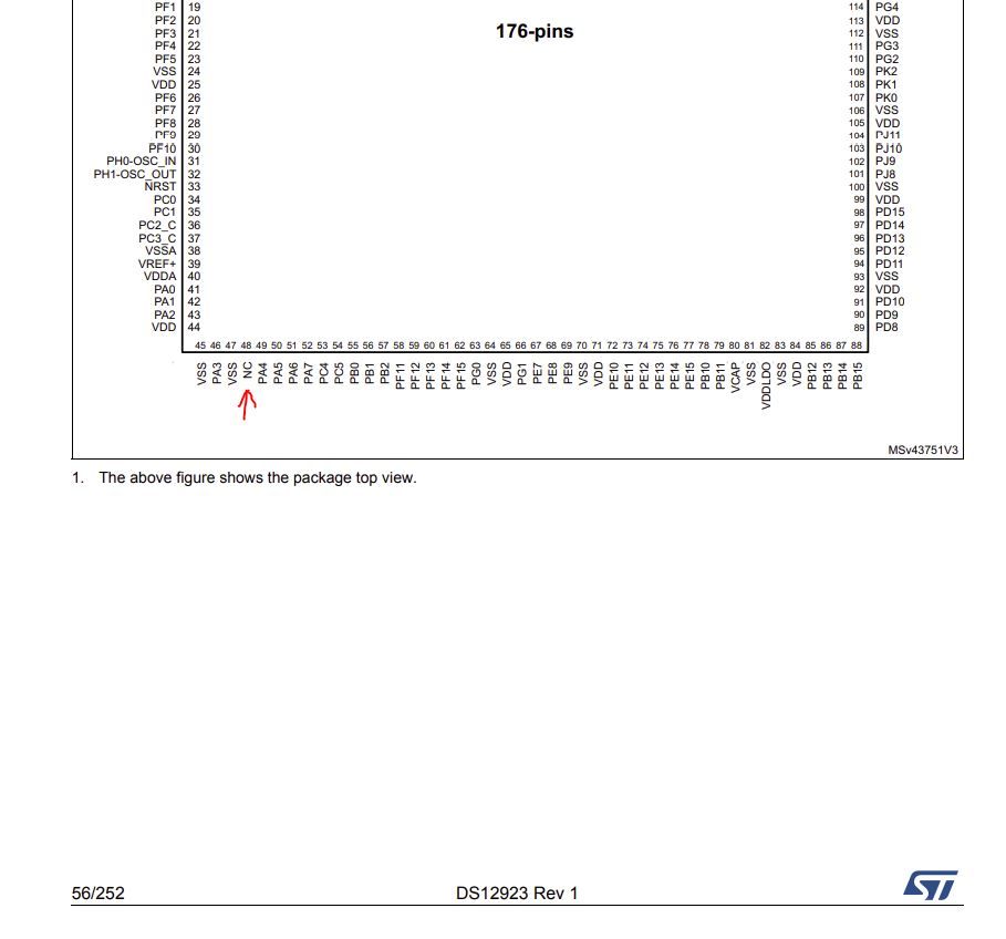

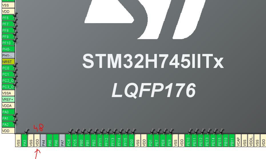

There is a difference between CubeMx and the datasheet. from Pin48
https://community.st.com/s/?t=1610970558389
Datasheet - STM32H753xI - 32-bit Arm® Cortex®-M7 400MHz MCUs, up to 2MB Flash, 1MB RAM, 46 com. and analog interfaces, crypto
page 56/252
Datasheet pin48 = NC
CubeMx pin48 = VDD
What is right ?

Hello Hans T,
Thanks for your feedback. You're right, the issue will be reported internally to be reviewed and fixed.
I'll keep you posted.
Thanks for contribution.
