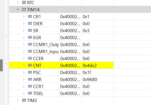

void TIM14_init(void){

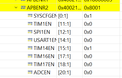

RCC->APBENR2|=(1<<15);
TIM14->PSC= 31;
TIM14->SR=0;
TIM14->CNT=0;
TIM14->EGR|=(1<<0);
void TIM14_delay_us (int delay_us){
TIM14->ARR = delay_us;
TIM14->CR1|= (1<<0); // counter enabled
while (!((TIM14->SR)&1)); // wait Update flag to be set
I have written these two functions to init TIM14 and perform a us delay. It seems to not work. Can you help me?

I discovered that they works correctly but only if TIM14_delay_us is put after this function MX_GPIO_Init(); that MX produces automatically (I am not using any HAL functions but only creating the project automatically in STM32 cube ide selecting the nucleo board that I am using and MX_GPIO_Init(); comes out)
TIM14_delay_us works fine if it is used in the while(1) loop after all the init functions.
TIM14_delay_us does not work if it is used before MX_GPIO_Init();
I did not figure out why it is happening so far

If I call the function only one time, in the TIM14 register I can see the UIF flag immediately raised (eventhough I write TIM14->SR=0;). I can see it in live expression

> TIM14->EGR|=(1<<0);
This sets the Update flag so clear SR before you start the counter in delay.
Also stop the counter after delay.
JW​

‎2022-10-21 1:10 AM
Isn't it that only the very first delay after reset "does not work" (finishes much faster than all subsequent calls of the function)? If yes, that's because you *do* need the forced update (by setting EGR.UG) after setting PSC, as PSC is unconditionally preloaded. In other words, the very first run of that function works with the default PSC=0, and only after the Update happens at the end of that first run, PSC gets loaded and subsequent calls use it.
